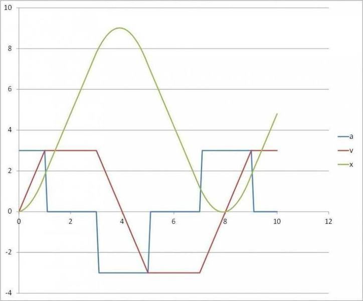

Okay, so say we had the following situation: An object accelerates from rest to 3 m/s in 1 second. It then maintains this velocity for 2 seconds before decelerating to a velocity of -3 m/s over the span of 2s. It maintains this velocity for a further 2 seconds. The object then accelerates back up to a velocity of 3m/s in 2 seconds, which it then travels constantly at for a final second.
I want to know if it would be possible to come up with an equation which would sketch a graph which would look like this. I would prefer the equation to be this exact graph, but an equation which sketches the same general shape of this graph would also be fine. Also, if it is possible to do, does the graph which follows this general shape have a specific name?

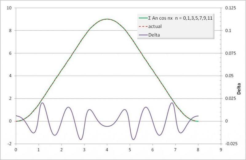

Coming back to this series approximation: your function looks like a cosine, so a Fourier expansion should be appropriate. Depending on how accurately you want to reproduce the function, you need a good number of terms. I played with excel Fourier analysis and found that coefficients for ##\cos(nx)## with n = 0,1,3,5,7,9,11 namely
4.5 -4.37861 -0.16217 0.035028 0.012765 -0.00601 -0.00329
give a maximum error of 0.02 (function range 0-9)
The Gibbs phenomenon isn't distinguishable, probably thanks to the first derivative being continuous :wink:
What do you mean by "actual"?
His velocity function does not look like this.
It has flat portions at both maximum and minimum velocity.
I agree, I assumed the poster was asking for the position function.

I only see discontinuities in the a(t) graph - must admit the excel picture doesn't do them justice (took steps of 1/16 sec to get 128 steps from 0 to 8. The 128 is inspired by a queer restriction in excel Fourier analysis: it wants powers of 2).
Curious to hear from Bill if such an approach satisfies his needs ...
