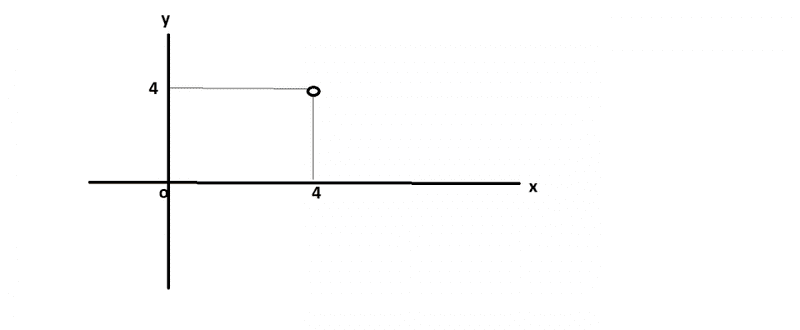

I want to know what does it mean electric field E⃗ =(4iˆ+4jˆ) N/CIs it equation of electric field line?But how will it represent electric field line.Because it is only a point.
Coordinate axes with x and y labelled, a y-axis mark at 4 and an x-axis mark at 4, and an open circle at the point (4, 4).
It's not a point, it's a vector. ##\mathbf{E} = 4\hat{i}+4\hat{j}## physically means that there is a uniform electric field in the x-y plane directed 45 degree from the x (or y) axis with the strength ##4\sqrt{2}## N/C.

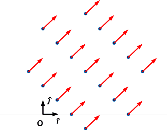

Back to post #1. What does "the electric field ##\vec E = (4{\bf \hat\imath} + 4 {\bf \hat\jmath}) ## N/C" mean ?
It means that at every point in the plane, the electric force per coulomb is a vector with an x-component of 4 and a y component of 4 . So it must point in a direction with an angle of ##\pi\over 4## wrt the positive x-axis. Hence the magnitude ##4\sqrt 2## in an earlier post.
Diagram of a uniform field of identical red arrows, each pointing up and to the right at 45 degrees, placed on a staggered grid of blue dots. Axes labelled O, i-hat and j-hat mark the origin at lower left.
  • Diagram of a uniform vector field: a grid of red arrows, all of equal length and pointing up and to the right at 45 degrees, with blue dots marking their tails. Axes labelled O, i-hat and j-hat in the lower left.

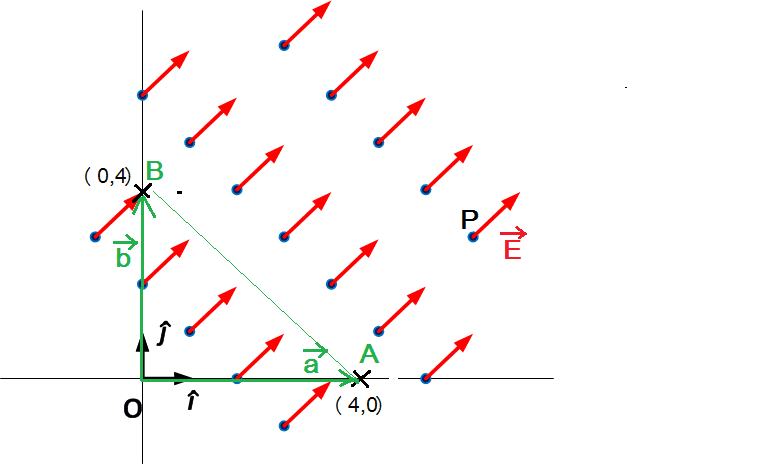

There are position vectors, pointing to a point from the origin, and there are free vectors, representing vector quantities which are functions of position. The independent variable is position vector and the dependent variable is a free vector.
Diagram of a uniform electric field as parallel red arrows of equal length pointing up and to the right, on a coordinate grid. Points A at (4,0) and B at (0,4) are marked, with unit vectors i and j at the origin O and position vectors a and b drawn to A and B; a line joins A and B and P and E are labelled.
The electric field is free vector, ##\vec E ## in every point P. It is the same vector at point A (position vector ##\vec a ##) and also at point B (position vector ##\vec b ##) .
The potential difference VB-VA is equal to the negative work done by the electric field when a unit positive charge moves from A to B. When the field is uniform, this work is equal to the electric field times displacement, ##W=\vec E\cdot\Delta \vec r##. ##\Delta r = \vec b-\vec a##. Calculate ##\vec \Delta r ## and multiply it by ##\vec E##.
You certainly remember what you learned about equipotential surfaces, that they are perpendicular to the field lines. Here the field lines are straight lines with slope 1. The equipotentials in the plane are lines perpendicular to the former ones, having slope -1. The displacement from ##\vec a - \vec b## is along an equipotential.
