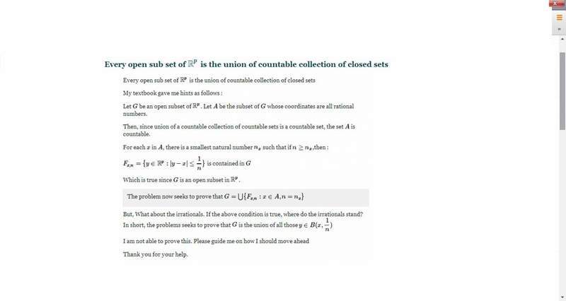

Every open sub set of Rp is the union of countable collection of closed sets.
I am attaching my attempt as an image file. Please guide me on how I should move ahead. Thank you very much for your help.
Take an irrational number ##a## in ##G##. You can find a certain open ball ##B(a,\varepsilon)## which remains in ##G##. What can you tell about the rational numbers in that ball? In particular, if ##q\in B(a,\varepsilon)## is rational, what can you tell about the closed set in the hint?
This is equivalent to R^p being 2nd-countable.
I think I got it. Thank you for your comments
