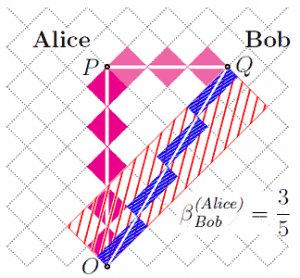

  • #39
In addition, I think that physics textbooks only highlight Einstein's "transformations" approach
but hardly any of Minkowski's "spacetime geometry" approach [which is often regarded as too difficult].
In my opinion, words and logic are not enough... "a spacetime diagram is worth a thousand words".
What's wrong with using geometry (or at least a sketch of the geometry) as a crutch for a non-intuitive subject?

One way to describe time-dilation is with a Minkowski-right-triangle [with a timelike leg and orthogonal spacelike leg ] with a timelike hypotenuse.
The time-dilation factor is the ratio of the timelike sides: longer-leg/shorter-hypotenuse...
The Minkowski-angle between the timelike leg and timelike hypotenuse is the rapidity and
the time-dilation factor is cosh(rapidity) [so the timelike leg is the side adjacent to the rapidity].
An identity for cosh(rapidity) takes a possibly familiar form: cosh(rapidity)=1/sqrt(1-tanh^2(rapidity)).

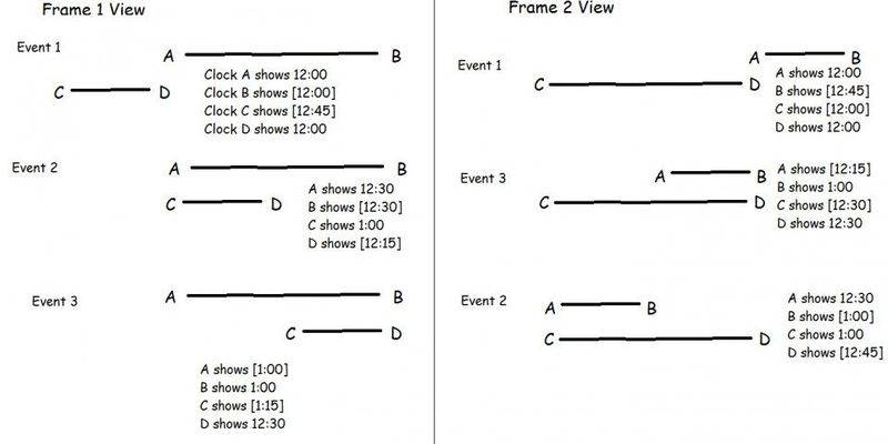

  • #49
Mister T said:
Fundamentally, saying lengths contract could be just as misleading as saying time slows down. Learners (for example, students) might be less likely to encounter the conceptual disconnect presented by the OP when it comes to considering lengths, but it is nonetheless there.
But proper lengths or displacements in one frame are always measured to be shorter in another frame that is moving in the direction of that displacement. An observer in a rocket ship moving at .9999999999c relative to the Earth in a direction toward the Andromeda Galaxy, which is located at a proper displacement of 1,000,000 light years from earth, measures Andromeda as being only about 14 light years away. And the observer finds that his rocket ship only takes about 14 years to get there.
When transforming a length ##\Delta x## from a stationary frame to the ##\Delta x'## of a moving frame we could find, for example when ##\Delta t## is zero, that ##\Delta x'## is larger than ##\Delta x##.
This would not be the case if Δx is a proper length eg. the length of a ruler at rest lying on the x-axis in that inertial frame. All inertial observers moving relative to that ruler in the direction of that x-axis will measure that ruler to be shorter than its proper length. They would also measure the clocks in that frame to be moving slower than the observer's clocks.
These effects are real, as in the muon decay example. Another illustration is the narrow forward-directed cone of light emitted by relativistic charges in a synchrotron.
