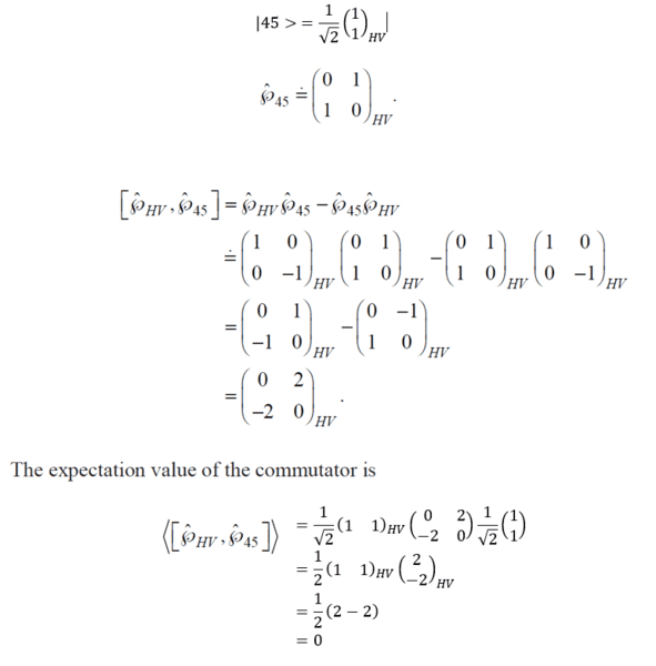

I'm trying to extract the expected value of a |+45> polarized photon in the HV- base. I do it in two ways, one is correct and the other I get wrong answer. What am I doing wrong in the first method that is wrong?

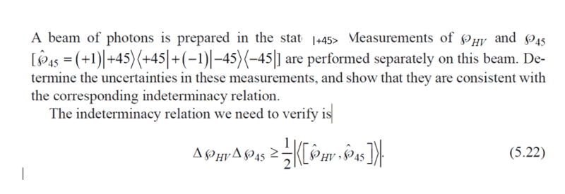

The real problem is
I get the expectation value of the commutator to zero, even for operator | 45>. This can not be correct. I can not solve this problem, can you help me?

The problem formulation is of little use unless you define the ##|45\rangle## basis in terms of the HV one and define what is meant by ##\mathcal P_{HV}##. Since you have not told us what textbook you are using and we most likely will not have direct access to it, this is crucial information.

So what is the problem?
The expectation value of the commutator should NOT be zero. the commutator do not commut therefore the answer is wrong
No it isn’t. In fact, the expectation of the commutator must be zero for the given state! Anything else would violate the uncertainty relation.
