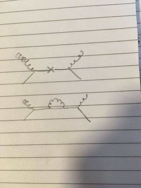

Say I have the 2->2 process, ##(g q \rightarrow gq)##, illustrated in the attachment. I'd like to write out the Feynman rules for both diagrams. The second one I know how to do but what is the Feynman rules expression for the diagram with the mass counter term insertion (the 'X')?
  • Hand-drawn Feynman diagram with a cross-shaped mass counterterm insertion: a curly gluon line meets a quark line at an X vertex, with an outgoing curly gluon and quark line on the right. Below it, a quark self-energy loop diagram.
In the first diagram, without the counter term insertion, it's just a s channel type diagram with propagator momentum ##p_1+p_2##. Now add the counter term. It splits the propagator line into two lines, each with momentum ##p_1+p_2##. The Feynman rules is then $$\frac{(\not{p_1} + \not{p_2})_{\alpha \beta} + m \delta_{\alpha \beta}}{(p_1+p_2)^2-m^2} \cdot -i(Z_m-1)m \cdot \frac{(\not{p_1} + \not{p_2})_{\beta \eta} + m \delta_{\beta \eta}}{(p_1+p_2)^2-m^2}$$
Could someone tell me if that is correct feynman rules for the counter term?
If the -i in the counter term is just a sloppy (-i), then I would agree (up to factors of i that I did not check).
Note that you will also need to include the wave function counter term.
