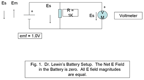

Battery example (Lewin’s battery setup)
For example, in his battery setup (Fig. 1) Dr. Lewin assumes a net battery E field opposite to the direction of the E field in the resistor. In fact the battery contains two canceling field contributions: E_s points + to − and E_m points − to +. The line integral of E_m over the battery (- to +) is the battery emf. A voltmeter senses only the line integral of E_s; otherwise a DC voltmeter directly across a battery would read 0 V. In the resistor E_s points + to −; the circulation of E_s around the loop is zero as required by Kirchhoff’s voltage law. The circulation of E_m, and thus of the net E, equals ##iR## (with ##i## the current and ##R## the resistor).*
Lewin battery setup

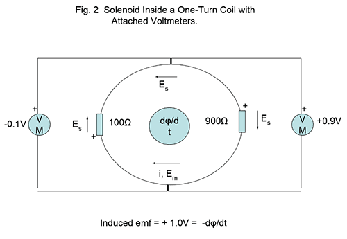

Solenoid and single-turn loop (voltmeters placed near the loop)
Now to address the main topic — the solenoid, the single-turn loop, and voltmeters positioned as shown in Fig. 2 — assume again that the loop wires have negligible resistance.
Solenoid and loop
Definitions
  • ##\phi## = magnetic flux inside the loop
  • loop radius = ##a##
  • loop current = ##i##
  • total loop induced emf = ##\oint \mathbf{E_m}\cdot\mathbf{dl}##
Hence,
$$ E_m = \frac{\frac{-d\phi}{dt}}{2\pi a}. $$
Around the loop (with or without resistors ##R1## and ##R2##) a continuum of E_m exists and an opposing E_s runs in the opposite direction. Inside the resistors E_s can be large because ##E_s = iR/d## with ##d## the length of each resistor and ##d \ll 2\pi a##. All of this follows from ##\oint\vec E_s\cdot d\vec l = 0##; the line integral of the resistors’ E_s fields equals the scalar emf ##\mathcal{E}## and is canceled around the loop by wire-segment E_s fields.

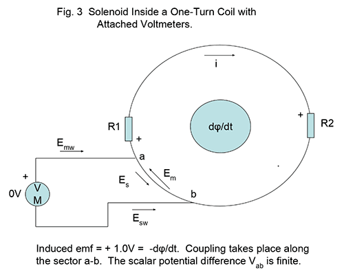

Why a voltmeter placed on a wire section reads zero
Next, show that a voltmeter connected at two points a and b along the loop that do not include a resistor reads 0 V (Fig. 3). Although this can seem paradoxical, it is consistent once the two-field picture is used.
Voltmeters on the loop
First, remember that in an ideal conductor the net electric field must vanish. Thus in the wire segments (including the shorter section a–b and the meter leads) the conservative and emf-induced fields must be equal in magnitude and opposite in sign.
Voltmeter model and notation
  • ##E_{mw}## = the emf-induced field in the meter leads
  • ##E_{sw}## = the static (conservative) field in the meter leads
  • ##E_{sv}## = the static field in the voltmeter
  • ##E_{mv}## = the emf-induced field in the voltmeter
  • ##l_w## = the total meter lead length
Model the voltmeter as a resistor of finite physical length ##d## with resistance ##r##, carrying a tiny current ##i_v##. The meter reads ##i_v\cdot r##. Because ##E_{sv}## and ##E_{mv}## oppose each other inside the meter,
$$ i_v\cdot r = (E_{sv} – E_{mv})\cdot d, $$
or equivalently
$$ d\cdot E_{sv} = i_v\cdot r + d\cdot E_{mv}. $$
Now perform the circulation of E_s around the meter circuit:
## +E_{sw}\cdot l_w + i_v\cdot r + E_{sv}\cdot d \;-\; E_s \theta a \;=\; 0. ##
The circulation of E_m around the same contour is zero if there are no emf sources inside/around that contour:
## E_{mw}\cdot l_w + d\cdot E_{mv} \;-\; E_m \theta a \;=\; 0. ##
Combining these, and using that inside ideal conductors the two field components match in magnitude (so the meter lead magnitudes satisfy ##E_{sw}=E_{mw}## and the wire segment magnitudes satisfy ##E_s=E_m##), one finds
## i_v\cdot r = 0 \Rightarrow i_v = 0 \Rightarrow \text{VM} = 0. ##
Thus VM = 0 for an uninterrupted wire segment of the loop. If the voltmeter probes a length of wire with a resistor ##R## in-between, the voltmeter reads VM = ##iR##, independent of the lengths of the surrounding wire segments. This result includes Lewin’s A and D probe points at the top and bottom of the loop illustrated in Figs. 2 and 3.

Further remarks and a quantitative example
I emphasize that voltmeter readings in Lewin’s setup can be entirely accounted for without splitting the E field into E_m and E_s. The split is, however, useful for insight: it explains the difference between meter readings and scalar-potential differences. It is not merely meter lead dressing; any meter loop in any orientation will give the same coupling results. The effect is simply sharing of E_m and E_s between the main loop and the meter loop. As McDonald notes, to avoid coupling effects the meter probes should be connected directly at a resistor; otherwise scalar-potential measurements will miss contributions associated with loop wiring.
Lewin did not, to my recollection, place the VM leads in the middle of the solenoid. If he had, the reading would be halfway between −0.1 V and +0.9 V, i.e. +0.4 V. Reflecting on the numerical mismatch between expected and actual VM readings: the R1 meter reading was −0.1 V − 0.4 V = −0.5 V (too negative), while for the R2 loop it was +0.9 V − 0.4 V = +0.5 V (too positive). If we integrate the E_s field over the meter loop with the meter positioned halfway above the solenoid, the line-integral sum gives
## \mathcal{E}/2 – iR2 + \text{VM} = 0 \quad\Rightarrow\quad \text{VM} = +0.4\text{ V}. ##
Or, equivalently,
## -\text{VM} + \mathcal{E}/2 – iR1 = 0, ##
which also yields VM = +0.4 V and agrees with the data. Suspending the voltmeter with its leads directly above the magnetic source gives the expected voltage.

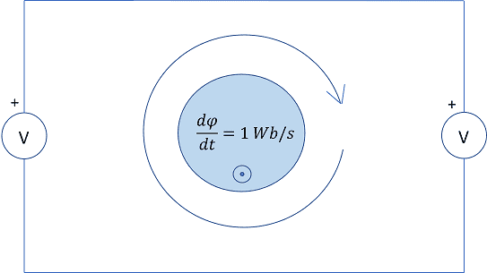

    There is no paradox whatsoever!. I admit, it took me a while to understand what is going on.
    First thing first, the loop with two resistor is a red hearing. So, let's remove it and we get a circuit like that:
    Now, we have a loop containing two voltmeters encircling flux change of 1 Wb/s. Obviously, the induced EMF is 1 Volt and the direction is indicated by the circular arrow. With the way the voltmeters are connected, the one on the right would show a positive voltage, the other negative voltage, just like in the video.
    How much will each of them show?. That would depend on the internal resistance of the voltmeters. Portable meters have resistance of 10 Mohm, if both have this value, one will show 0.5 V, the other -0.5 V. Change the internal resistance of the left voltmeter to 1 Mohm and the other one to 9 Mohm and you will get -0.1 v and 0.9 V. No paradox, just a red herring.
    However, Dr Lewin makes a statement in his video that I would disagree. He says that the Kirchhoff (second) law is not valid. The way I was thought physics, it is still valid. I understand that the Kirchhoff law says that for a loop ##sum I_k R_k = sum EMF## and that actually agrees with the Faraday law.

    Oops, missing post? Somebody asked,
    Hi
    In figure 2 inside the resistors, do the Em and Es fields add and help rather than oppose like they do in the connecting wire?
    The answer is yes, they are both clockwise in the figure. E[SUB]m[/SUB] is always clockwise but in a resistor the E[SUB]s[/SUB] field points + to – so they add.
    Line-integrated E[SUB]m[/SUB] will be small, especially if the resistor is short, but line -inegrated (E[SUB]s[/SUB] + E[SUB]m[/SUB]) = iR so you can see that E[SUB]s[/SUB] is the dominant field in R.
