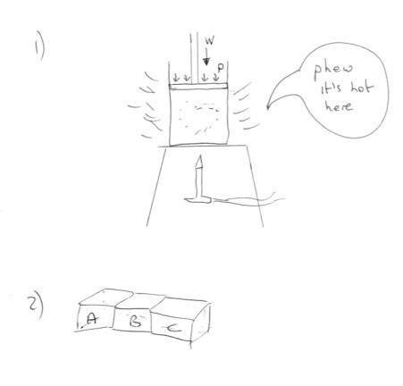

You are right it would be worth you while to review some fundamentals.
I have three gold blocks A, B & C on my desk, sitting quietly side by side.
As such they are in mechanical equilibrium.
Since they are touching and no heat is transferred between them they are said to be in thermal equilibrium. (note I say thermal equilibrium, not thermodynamic equilibrium).
This exemplifies what is sometimes called the zeroth law of thermodynamics.
Two bodies in thermal contact are at the same temperature if no heat passes between them.
Further if B is at the same temperature as A and at the same temperature as C then A is at the same temperature as C.
Seems obvious, but it is surprising how often we use these.
Final point from this. One body is not in ‘thermal equilibrium’ – it takes at least two bodies.
Now let me put these blocks in my pocket take the lift (elevator) up to the 10th floor.
The blocks are no longer in mechanical equilibrium since they are being accelerated by the lift.
But they are still in thermal equilibrium since they are all still at the same temperature as each other.
Now look at the container of fluid.
Before I light the burner, the container and the fluid are in (thermal) equilibrium with the surroundings.
The temperature of the fluid is steady
No work is being done.
Neither the volume nor the pressure are changing. They are steady.
The system (fluid) is in a steady state.
When I light the burner and begin the add heat, the average temperature in the fluid rises and the average pressure increases.
However I can no longer talk of the temperature or the pressure of the fluid as both vary from top to bottom and the fluid churns over.
As the pressure increases this means that the average internal pressure exceeds the external pressure (plus the piston weight) so the piston rises and work is done against the external pressure.
Further since the container is not insulated, heat is lost to the surroundings.
Another way to say this is.
The fluid and its surroundings (remember I said you need two bodies) are at different temperatures and no longer in thermal equilibrium and , by definition heat is transferred to the surroundings.
So whilst the temperature and piston are rising the system is not in equilibrium.
Nor is the system in a steady state.
If I keep the burner low enough eventually a form of dynamic equilibrium is reached where the heat from the burner exactly equals the heat lost to the surroundings.
The system pressure and temperature stabilise at a single value and the piston stops rising so the volume stops changing and no work is now being done.
The system is again in a steady state.
But the system is still not in thermal equilibrium with its surroundings because its temperature is different from that of its surroundings.
There is much more to be learned from these simple examples if you like the story so far.
This would include the difference between dynamic equilibrium and steady state and how we can sidestep the reversibility/irreversibilty problem.
