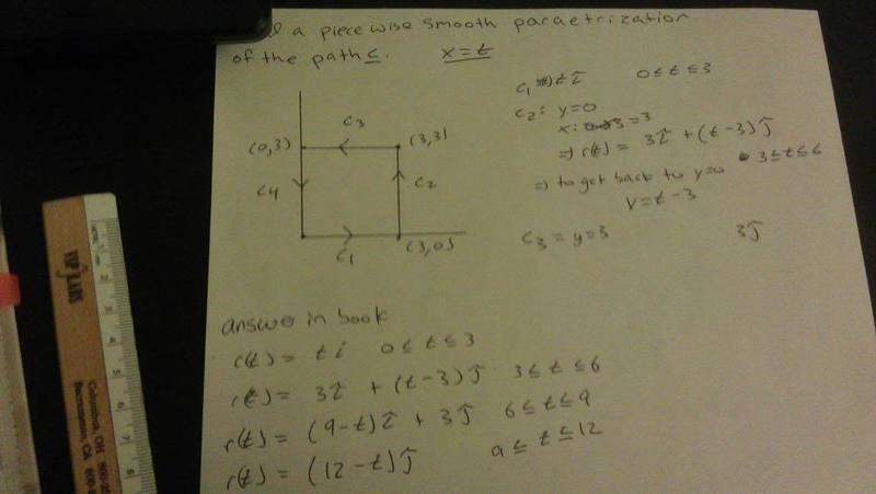

I am having a real tough time trying to build a parametrization of the path c. its a really simple one but my professor just briefly went over it, and I can't find the thought process to put it together. I know the equation of a plane curve r(t)=x(t)i+y(t)j and everything. But its just not making sense to me. I would really like to understand how the book got this answer, I know there are many answers but if I can figure this one out i might be able to see other ways. If you know a good vid for this stuff please link it.[PLAIN]http://i1341.photobucket.com/albums/o745/nebula-314/IMAG0094.jpg[/PLAIN]
Well,
c1: (x,y) = (t,0) : 0 < t ≤ 3
c2: (x,y) = (3,t-3) : 3 < t ≤ 6
c3: ... you should be able to figure the rest.
Then you can integrate from t=0 to t=12.
This is pretty much what the book says - but they use unit vectors.
To understand it, put a dot on the graph at the t=0 position, then watch where it goes as t gets bigger.

Since you already have the answer in the book, maybe it would make more sense to see why their parameterization works.
For the first leg, r(t) = ti, 0 ≤ t ≤ 3
Each value of t will get you to a point on the x-axis between 0 and 3. When t = 3, you're at the point (3, 0).
For the second leg, all the x values are 3, which explains the 3i component.
For the vertical component we want to map the t values from 3 to 6 to the values 0 to 3, so we subtract 3. This gives us r(t) = 3i + (t - 3)j, 3 ≤ t ≤ 6.
When t = 3, we're at the point (3, 0). When t = 4.5, we're at the point (3, 1.5). When t = 6, we're at (3, 3).
For the third leg, the y-value stays fixed at 3, but the x-value has to go from 3 down to 0, while the t values range from 6 to 9. If we were mapping [6, 9] to [0, 3] we could use t - 6, but we want to end up with [3, 0], so t - 6 won't work. Switching the order from t - 6 to 6 - t maps the t values in [6, 9] to x values of 0 to -3, so they're off. If we adjust by adding 3 to 6 - t, we get 9 - t, and this correctly maps t values between 6 and 9 to x values from 3 down to 0. So r(t) = (12 - t)i + 0j, 6 ≤ t ≤ 9.
The last leg keeps x fixed at 0, but maps t values from 9 to 12 onto y values from 3 down to 0. I leave it for you to figure out a formula for this part.
