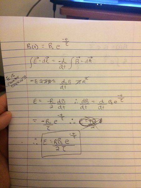

mkematt96
25
See picture above
Int (E dot dl) = Int (B dot dA)
Where did I go wrong? Is there a sign error possibly or am I off conceptually? [/B]
The only thing I see that is incorrect is in your relevant equations (2), it should say ## -dB/dt ## instead of ## B ##. Their ## dl ## in the figure is in the opposite direction of what it should be, but I don't think that is your mistake. The line integrals in these Stoke's formulas always go counterclockwise with +z out of the paper. Perhaps the instructor wanted you to spot that anomaly, etc...
