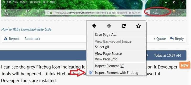

I can see the grey Firebug icon indicating it is deactivated. Whenever I click on it Developer Tools will be opened. I think Firebug is always deactivated because more powerful Deveoper Tools are installed.Senmeis
That just means that it isn't currently active. If installed correctly, you should have the option shown below.
