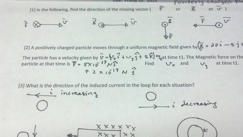

Find the direction of the missing vector?
  • Thread starter Thread starter ugobroncs3343
    Direction Vector
To determine the direction of the missing vector, apply the right-hand rule as a fundamental principle. This involves orienting your right hand so that your fingers follow the direction of the first vector and curl towards the second vector, with your thumb indicating the direction of the resultant vector. Clarification is needed on whether the vector B points up or down in the specific scenario presented. Drawing the missing vector into the picture can help visualize the solution. Understanding these steps will aid in accurately solving the problem.
ugobroncs3343
The picture shows the problem
I know that the right hand rule applies but I am confused on exactly what to do from there?
Any help would be greatly appreciated thank you
I guess you asked about [1].
Apply the right hand rule to find he direction of the missing vector, then draw it into the picture. For example, does B point up or down in the first case? ehild
