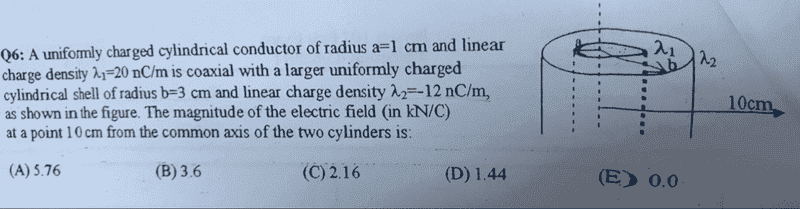

##Q_{enclosed} = 0 ## , because there is no charge inside the conducting cylinder.
E = 0
Can anyone check my answer please ?
The point in question is not inside the conducting material. It's at a point 10 cm from the axis, well beyond the conducting shell.

rac%7B20*10%5E%7B-9%7D+12*10%5E%7B-9%7D%7D%7B2%5Cpi%20*8.85*10%5E%7B-12%7D*0.1%7D%20%3D%205.png
  • rac%7B20*10%5E%7B-9%7D+12*10%5E%7B-9%7D%7D%7B2%5Cpi%20*8.85*10%5E%7B-12%7D*0.1%7D%20%3D%205.png
Note that the charge on the conducting shell is negative.

7B20*10%5E%7B-9%7D-12*10%5E%7B-9%7D%7D%7B2%5Cpi%20%5Ccdot%208.85*10%5E%7B-12%7D*0.1%7D%20%3D%201.png
  • 7B20*10%5E%7B-9%7D-12*10%5E%7B-9%7D%7D%7B2%5Cpi%20%5Ccdot%208.85*10%5E%7B-12%7D*0.1%7D%20%3D%201.png
Now you've got it.
