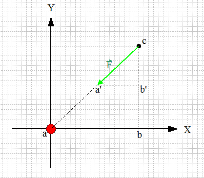

A proton is at the origin and an electron is at the point x = 0.36 nm , y = 0.34 nm.
Find the x- and y-components of the electric force on the proton.
E = kQ/r2
So I found that E = 9.38 * 10-28, but my problem is that I do not know how to determine the x and y components. I did a problem earlier that followed this way and got help on it, but the y was 0 so all magnitude was in the x component. I simply do not understand the strategy to find the two components using the given coordinate points.
You'll want to use the Coulomb equation for the force between two charges, and you'll need to use a bit of trigonometry to decompose the force magnitude that it gives you into x-y components. Start by making a sketch of the scenario and indicate the force vector. Similar triangles can be useful.

Alright, so now that I have the magnitude. I created a triangle with sides .35 for y, and .34 for x with magnitude around .5. What do I do from here? Do I find the angle? I know that the triangle makes a 90 degree angle, but don't I need the angle for theta where the force is being applied.

Your sketch probably looks something like this:
You know the lengths of the sides of the big triangle abc. You also know the hypotenuse of the smaller triangle (side a'c). The triangles are similar, so just use ratios to find the lengths of a'b' and b'c. Be sure to assign the correct signs to the components.

Ok so I managed to get two values doing proportions. X is 6.8*10-10 and Y is 6.4*10-10. I believe they should be positive since it is the force on the proton. Am I correct on either piece.
The units are missing but the values are okay. I make the Y-value mantissa to be 6.5 rather than 6.4, probably due to your having rounded some value(s) during intermediate steps. Try to keep extra digits during intermediate calculations and only round at the very end.
