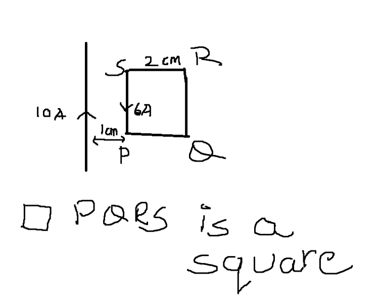

A square loop PQRS carrying a current of 6A is placed near a long wire carrying 10A as shown in the figure. Find the magnetic force on the square loop.
F = B * i * l ...... (1)
B = (µ0 * i)/2 π r
I tried finding out the answer by applying the formulas given above, I tried finding B [by (2) ]and putting it in the equation (1) but I did not get the correct answer.
BTW the answer is
1.6 x 10^-5 towards right.

You must find the B-field at the wires PQ, QR, RS and SP. Then find and add the forces.
Hint: Consider the forces FPQ and FRS

Hello Abs. Welcome to PF !
What did you get for the answer, and what are the details of how you got it?

I got 1.22 x 10^4
I first found out the magnetic force on P then S then Q and then R and took a mid point in the center of the square and I got four values and I found their arithematic mean and I got 1.22 x 10^4

But we are supposed to find the force, then what good would it be to find force excewpt that it can be put in eqn (1)
Using F = B*I*L will not give any force at a mid point, which has a length = 0.
Force = B-field * current * Length of wire.
So find the B-field along the length SP, and find by use of (1) the force FSP, and so on.

Wow, I made a big blunder there is nothing in the middle to be magnetized damn that was stupid of me.
Thanks Hesch
Just one more question,
When I find B by B = (µ0 * i)/2 π r
Do I have to find it for SR and PQ ? If yes then how do you find it in a horizontal wire ? I know how to find it in a vertical wire

As for RS and PQ the B-field will not be homogeneous, but anyway the forces FRS and FPQ will be symmetrical and counter-acting. So forget them.
Abs said:
After I find all the Force(s) do I add them ?
Yes. Be careful with directions.
