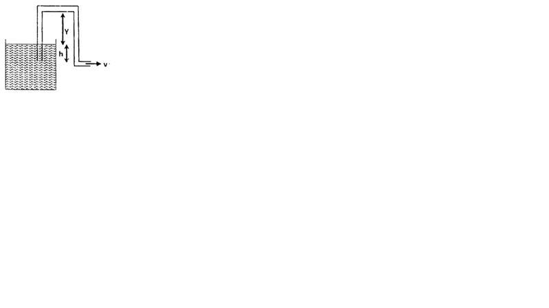

Find v
Bernoulli
Here's what I've done
I took the surface of water as first reference and the right-end of the pipe as second reference, so:
P1 + 1/2 ρV12 + ρgh1 = P2 + 1/2 ρV22 + ρgh2
P1 = P2 = Patm and I assumed v1 = 0 and h1 = 0, then the equation became:
0 = 1/2 ρV2 - ρgh
v = √(2gh) ---> ta daa, I'm finished with degree of confidence 0.5 % that my answer is correct.
Do I get it right? Thanks
It is 100% correct.
However to build up your confidence let's just clear up how we got here.
After applying the equations, we realized two things.Pressure at surface and Pressure at exit are same as they are open to atmosphere.
Then we made velocity zero.
That was using equation of continuity as surface area of water is much greater than that of pipe.
Ah I get it. Thanks for the help :smile:
