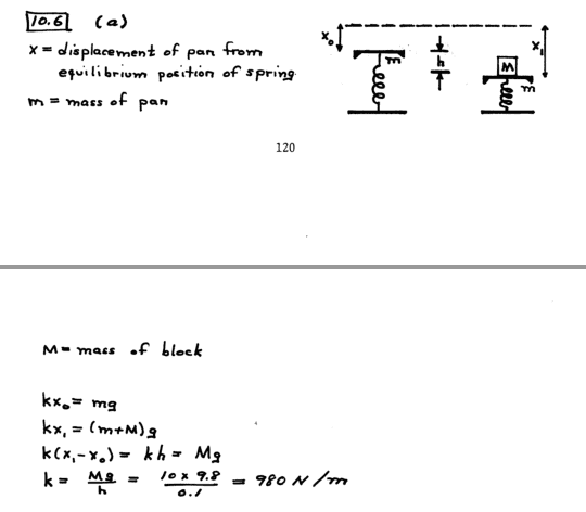

In summary: The solution you found on the net interprets the "eventually comes to rest" as meaning after oscillations have died down (due to damping). This makes the initial fall of the mass irrelevant; it could have been placed on the pan gently.Of course this will give a different answer to the one you found.

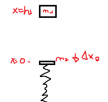

This is my scope of the question, i could think to solve it by two steps, but before, let's give name to the things.
X is positive down direction.
X = 0 at the initial position o the platform
Mass of the falling block is m1
Mass of the platform, m2
Spring constant k
Δx is the initial stretched length of the spring
h1 is the height of the block
h2 is the final distance (0,1m) of the origin
vb is the block speed
vc is the both bodies speed
vb² = 2gh1
m1*vb = (m1+m2)*vc
(m1+m2)*vc²/2 + kΔx²/2 = -(m1+m2)*g*|h2| + k(Δx + h2)²/2
Δx = m2*g/k
That is a system possible and determined, but why this is wrong?
I see we could apply kx before and in the final scenario, but why the first attempt is wrong?
The question is not entirely clear. It says "eventually " comes to rest. That suggests it is at the new equilibrium position, so the initial drop is irrelevant.
You have interpreted it as "first" comes to rest. Under that view, your work looks correct to me. How do you know it is considered wrong? Do you get a numerical answer different from a given one? If so, what are the two numbers?

HI :D I have no a numerical answer, but there is this solution on the internet
I think this is correct too, since the question says that in both cases the spring is in rest. If this is right, i agree that my answer would need too, but solving leads to differing values.
Are you sure the answer on the net is the intended interpretation? Was it provided by the person who set the question?
