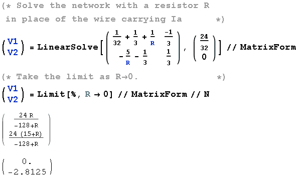

It seems we can't do a nodal analysis because the place where we would want to have a node (the junction of the 32 ohm and the 3 ohm resistors) is shorted to ground.
A technique I've used in cases like this is to replace the wire carrying Ia with a resistor R. Then perform the nodal analysis and take the limit as R goes to zero.
Let the aforementioned junction be V1 and the right end of the 3 ohm resistor be V2 (also Vm). Then we can form two nodal equations and solve them with matrix algebra:
Vm is -2.8125 volts.
