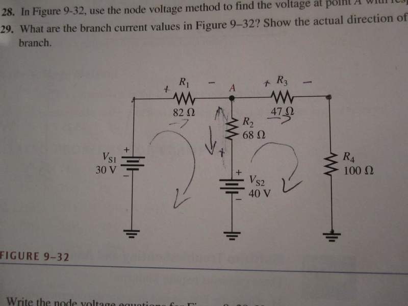

ive tried many things and can't seem to grasp the concept of KCL.i know the node I am looking for is between r1 & r3. i assumed i1+i2=i3. also looking for directions of currents.
V1=30v
V2=40v
R1=82
R2=68
R3=47
Vx = ?
i1 + i2 + i3 = 0 ?
(30-Vx)/82 + (Vx-40)/68 = Vx/147
anyone help me out with KCL and Nodal analysis? I've been trying for awhile and can't seem to wrap my head around it.
  • Circuit schematic labelled Figure 9-32 with node A between R1 and R3, showing VS1 30 V, VS2 40 V, R1 82 Ω, R2 68 Ω, R3 47 Ω and R4 100 Ω, with hand-drawn current arrows.

The trick is to make sure that the current directions that you choose for the sum will satisfy KCL at the given node. If you write: i1 + i2 + i3 = 0 then there is a tacit assumption that either all the currents are assumed to be flowing into the node, or all are assumed to be flowing out of the node.
Now take a look at your next equation. The first term (30-Vx)/82 is making the assumption that it the current is directed INTO the node. The next term (Vx-40)/68 makes the opposite assumption for current direction (it's directed OUT of the node). Placing the last term on the right hand side effectively changes its sign, so Vx/147 implies a current flowing INTO the node. So one out of three currents is mismatched in direction if you want to satisfy i1 + i2 + i3 = 0.
A simple way to avoid such current direction problems is to apply a fixed procedure to writing the equation for the node:
1) Assume that all currents flow OUT of the node
2) Write all the terms on one side of the equation, setting the other to zero.
Step 1 is accomplished by always taking the node potential first in the terms, and subtracting the fixed offset from the reference:
(Vx - 30)/82 + (Vx - 40)/68 + Vx/147 = 0
thanx for the reply. i asked my professor same question and it is becoming a little clearer. however I am still a little confused on my results, current flow and polarities. my answers are:
i1= -20.6 mA
i2=-172 mA
i3= 193 mA
these answer match up in the back of the book however i1= 20.6 ?
so does i3 + i2 = -i1 ? is this how i would analyze my answer?
how do i determine my results for current flow direction?
how do i know which currents to switch from - to + ?
do + currents flow into node and - flow out of node ?

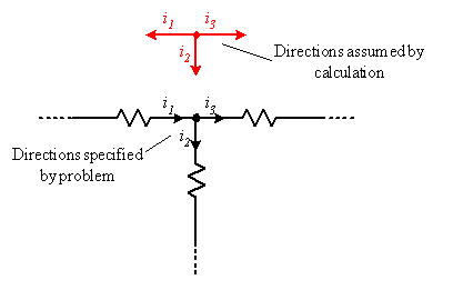

Well, it looks like you took my advice and solved for the currents assuming that they are all leaving node A. That means the assumed current directions are shown by arrows pointing away from node A along each branch. Now, if the problem has a particular direction indicated for any given current by which you are meant to judge the current, and the indicated direction happens to match your calculation assumptions then no problem, the calculated current signs match. If on the other hand the problem wants you to report the current as measured in the opposite direction, then you change the sign of your calculated result to match.
So for example, suppose the problem had certain currents and directions specified on the circuit diagram, but you solved mathematically with the assumption that all currents flow out of the node:
Two diagrams: above, red arrows pointing outward from a central node labelled i1, i2, i3, captioned Directions assumed by calculation; below, a circuit node with branch currents i1, i2, i3 with arrows, captioned Directions specified by problem.
Note that the calculated current i1 has the opposite direction from the current label in the problem diagram, while the other currents match in direction. That means you change the sign on your calculated value for i1 to match the diagram and leave i2 and i3 alone because they already match.
  • Circuit diagram with a node and three branches: directions assumed by calculation shown as red arrows leaving the node, labeled i1, i2, i3, next to directions specified by the problem, with black arrows on the branches labeled i1, i2, i3.
