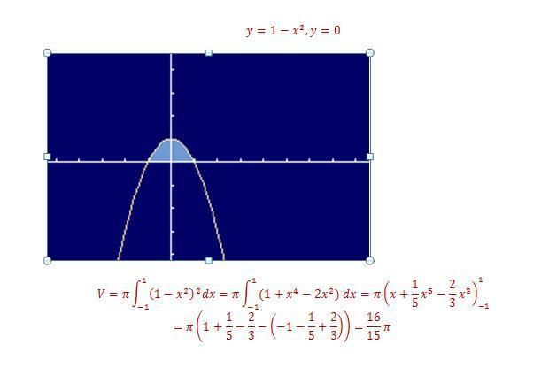

Find the volume of the solid obtained by rotating the region bounded by the given curves about the specified line. Sketch the region, the solid, and a typical disk or washer. About x axis.
1)
y=1-x2
y=0
I sketched a curve and a region. A typical disk and a solid? And please check the solution?

Everything looks good. Good job!

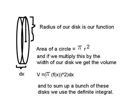

I drew a little sketch to give you some extra intuition on solids of revolution.
See figure.

That's great, thank you! I will try now to solve both of the problems. Let's see what happens.
Hey, where is the solid located on the function?
