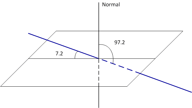

a) Find the acute angle between the line ## r = i+3j+5k+t (2i+4j+k) ## and the plane x-y+z=0
b)Two planes are defined by the equations ## x+2y+z=4## and ## 2x-3y=6 ##
i. find the acute angle between them.
ii. find a vector equation of their line of intersection.
a) [/B]I considered the directional vector ##p= 2i+4j+k## and the normal to plane ## q= i-j+k##
##p.q=|p||q| cos θ## using this i got ##θ=97.2^0 ##degrees. The textbook answer is given as ## θ-0.5π= 7.2 ##degrees

a) it says it wants the acute angle between the plane and the line. Make a drawing !
b i) what is the relationship between your two ponts and the planes ?
b ii ) ?
I am unable to make this drawing in 3d kindly assist..
Diagram of a ray hitting a plane at a point on a vertical dashed normal line labelled Normal, with the incoming ray making an angle of 7.2 with the plane and the outgoing ray making an angle of 97.2 with the normal.

Re a): is it clear your answer was 90 degree off because you calculated the angle between the normal and the line ?
So that in both cases you are allowed to use ##\min (\alpha, \pi -\alpha) ## ?

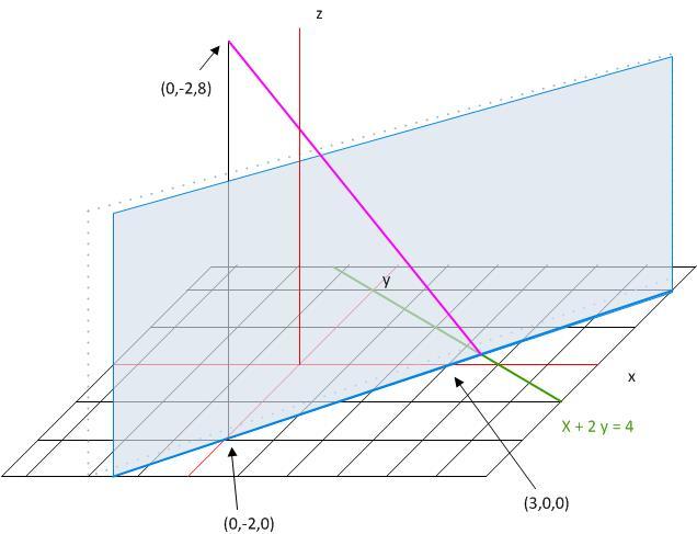

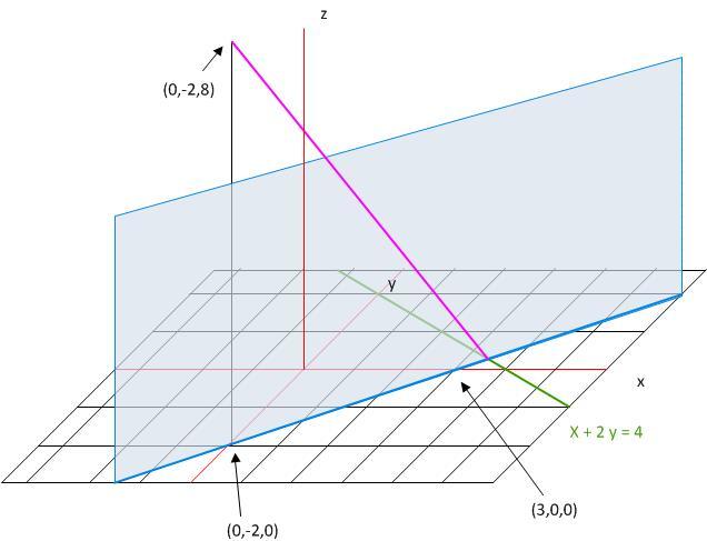

can you also draw the two planes in part 1b) above please...
That's a bit more awkward...A sensible representation of the first plane is a bit beyond my visio capabilities. Best I can offer is the second plane: a vertical (in the z direction) plane through (3,0,0) and (0,-2,0) (blueish) and the line (magenta) intersecting the two planes. Plus the intersection of the z=0 plane and the first plane: ##x + 2y = 4## (green). Picture doesn't show the angle between the two planes, though (blue and green line are not perpendicular) !
3D coordinate diagram with x, y and z axes and a grid on the z=0 plane; a blue vertical plane passes through (0,-2,0) and (3,0,0), a magenta line runs from (0,-2,8) to a point on the blue plane, and a green line labelled X + 2 y = 4 lies on the grid.
I should add three further comments:
For the two planes, you calculated the angle between the two normal vector directions. Since the angle between those two vectors is equal to the angle between the two planes, the (acute) angle = ##\min (\alpha, \pi -\alpha)## is valid.
For the intersection between ##x+2y+z=4## and ## 2x−3y=6 ## you used the words "on solving we get". What you did was that you found two points for both of which the two equations are satisfied. To me, 'solving' ##\ x+2y+z=4 \ \& \ 2x−3y=6 \ ## means you have to find all such points .
It isn't wise to use the same symbol for two different things: the choice of k in ##k=2i-3j## is confusing...

Can we also say that ## r(x,y,z)= (3,0,1) + t(-3,-2,7)## is a Vector equation for the two planes?
Kindly note that ##(3,0,1)## and ##(0,-2,8)## are both points that satisfy the plane equations. The two points can be expressed as a linear combination of each other.
How would these planes look like in a 3D plane?
No. It is a vector equation for the intersection of the two planes. The two planes each have a separate equation (##\ x+2y+z=4 \ ## and ## \ 2x−3y=6 \ ##). Points that satisfy ## r(x,y,z)= (3,0,1) + t(-3,-2,7)## are the points that satisfy ##\ x+2y+z=4 \ \& \ 2x−3y=6 \ ## (i.e. both equations).
Kindly note that ##(3,0,1)## and ##(0,-2,8)## are both points that satisfy both the plane equations.
No. Clearly ##(3,0,1)## is not a multiple of ##(0,-2,8)##
See post #9. One is the blueish plane. The other is the plane that contains both the green and the magenta line.
