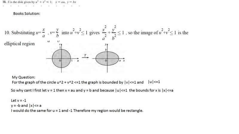

My question is in the paint document.
And I think I know the answer to my question. I asked why can't I let v = 1 then my first first region transformation would
the line y = b between -a≤x≤a.
The reason I think I can't do this is because the end point v = 1 is a point and not a line segment...
The graph is bounded by the rectangle ##|u|,|v|\le 1## but it isn't that rectangle. It is just contained in it. And the other graph is contained in the image of that rectangle, which is ##|x|\le a,|y|\le b##.
