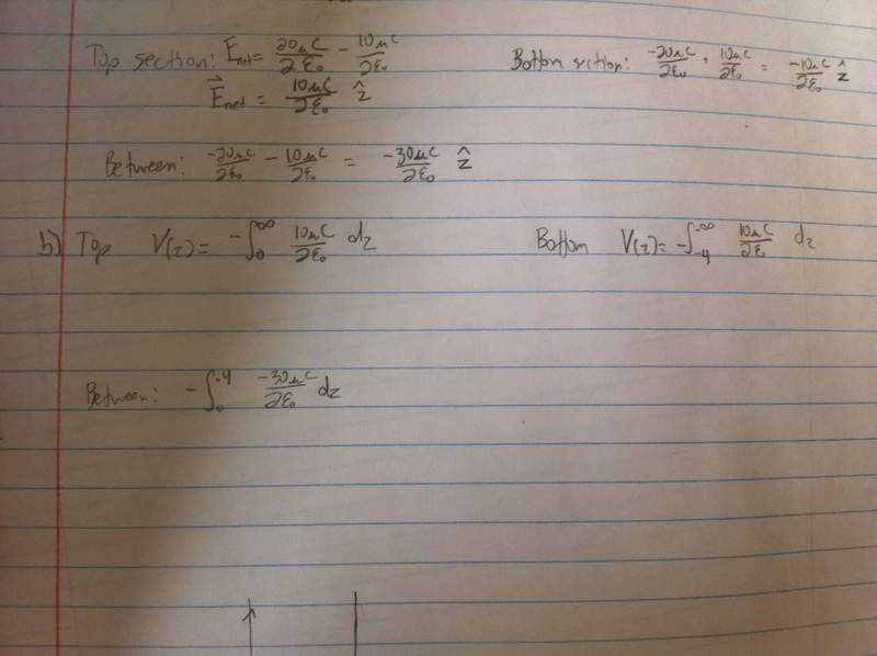

I know that Gauss Law has to be used. I am just a bit confused on the concept that the charge distributions aren't equal. This is throwing me off a little bit. Do I find the Q-enclosed for both individually, then add them?

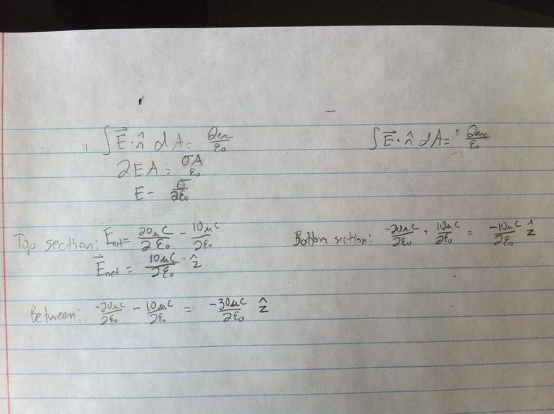

Hmm this is what I attempted to do. I have attached my work to this post to see if you can give me some pointers as to where I made a mistake. Thanks.
Edit: I don't know why the picture is rotated. It's not like that when I upload it. Sorry.

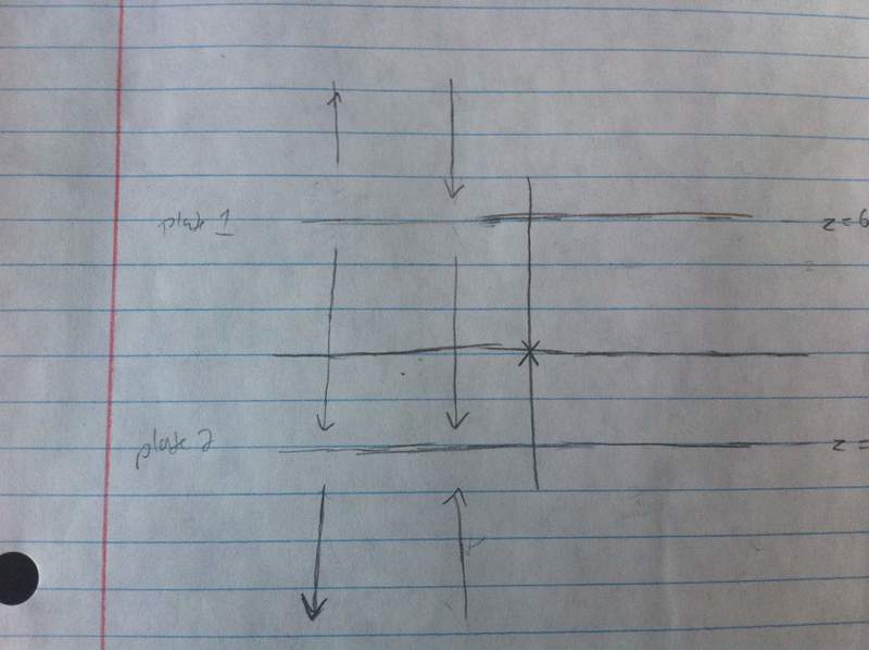

I do not understand the arrows that you have drawn in the figure. Draw two arrows, no more no less, side by side in each region to represent the fields contributed by each plate. Then we'll have something to talk about.

The top plate is positively charged and the bottom plate is negatively charged. You have the arrows mixed up. Also in the in-between regions you have more than two arrows and have not labeled any of them, so it is not clear which arrow is contributed by which plate.
Oh I had read the problem wrong. Ok I fixed the directions of my arrows. For the in-between regions I only have two arrows, the other lines are my coordinate axes. (the 'x' I drew is the origin.) I hope this makes it easier to follow.
Should I draw four arrows in the middle, even though they all point in the same direction? Two for each plate's contribution?

There are only two plates, so in each region there should be only two arrows, one from each plate.
Ohh I think/hope I got it now. The right column of vectors are the contributions of the bottom plate. The left column are for the top plate.

Yeah, there you go. Yes, I did mean top and bottom earlier, I was looking at your sideways drawing. :)

Ok I think I got part a. Any comments?
No comments. Looks OK.

Ok these are my integrals. I am a bit confused on the bounds. Did I set them up correctly?

Your upper limit should not be infinity because you are looking for the potential as a function of z. Also, the left side of the equation should be
V(at the upper limit of the integral) - V(at the lower limit of the integral)
V is taken to be zero only at the top plate, not anywhere else.

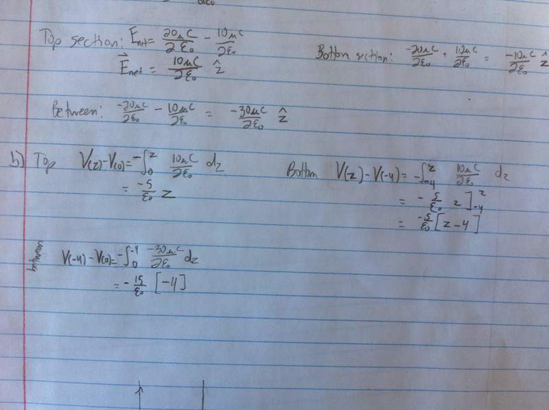

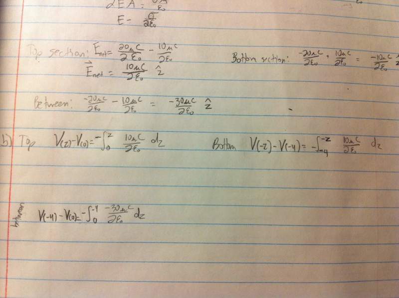

Ok I think I fixed both of my errors. Hopefully my equation for the bottom plate is correct. The directions got a bit confusing.

You actually need to evaluate the integrals to get functions that depend on z, V(z), in each region. I don't understand why some of your limits are y. What does y represent? And what is V(y)? Does your potential change when you keep the distance z from each plate and move sideways thus changing y only?
Right I didn't want to evaluate them until I got the bounds correct. And those aren't y's (sorry for my handwriting) they are supposed to be 4's since -4 is the location of Plate 1.
Then you're fine except that the upper limits for all integrals must be "z" with no negative sign because you are finding V(z) where z is an algebraic quantity that can be positive or negative. Also, be sure you find V(-4) relative to the zero that is given.
Ok for the top section, I got the V(z)-V(6)= (-5/epsilon-naught)z.
For the bottom I got V(z)-V(-4)= (-5/epsilonnaught)[z-4]
For between I got V(-4)-V(6)=60/epsilonnaught
Why wouldn't the top section be V(6)-V(z), if for the other two regions the potential at the lower z-value was subtracted from that at the higher z-value [for V(z)-V(-4), z is "below" -4, and for V(-4)-V(6), -4 is "below" 6]?
