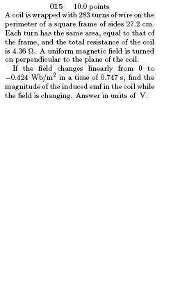

Finding Magnitude induced EMF in Coil
To find the magnitude of induced EMF in a coil, the relevant equation is e = d/dt(BAN), where B is the magnetic field, A is the area, and N is the number of turns in the coil. It is essential to show your work and the equations used in your calculations to receive assistance. If you're struggling to start, listing the equations related to induced EMF can help clarify the problem. Engaging with the equations will guide you toward the necessary information for your solution. Understanding these fundamentals is crucial for solving the problem effectively.
skaar
e=d/dt(BAN)
Hi skaar,
Welcome to PF! One of the rules of this forum is that you must make an attempt at solving the problem and then show your work (what equations you used and what numbers you used in them, for example) before we can help.
If you are having trouble getting started on the problem, I would suggest writing down the equations that relate to what they are asking for. Here they want to know the induced emf in the coil; what equations do you know (or can find in the book) that relate to induced emf? Once you have the equations in front of you, they can guide you as to what you need to know for the answr.
