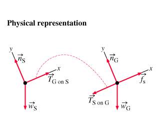

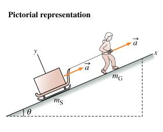

A girl of mass m_G is walking up a slippery slope while pulling a sled of unknown mass; the slope makes an angle theta with the horizontal. The coefficient of static friction between the girl's boots and the slope is mu_s; the friction between the sled and the slope is negligible. It turns out that the girl can pull the sled up the slope with acceleration up to a without slipping down the slope. Find the mass of the sled m_S. Assume that the rope connecting the girl and the sled is kept parallel to the slope at all times.

Your force diagrams are correct - so assuming have done the trig right you should be there.

Hint: use Newton's second law along the slope:
mGa + … = … ? :smile:

usual way of starting such problems is
frictional force is acting only on girl .
how to determine its direction?,,jst see where girl would slide if there was no friction force.
friction force is preventing that to happen...so it is in upward direction...
now, balance upward n downward forces...m_S would be the maximum one.
I have already done the force diagram and free body diagrams and such, as well as identified the action reaction pairs. I think their is an error in your calculation of m_s though, wouldn't it have to include "a" somewhere in there?

m_G*a have to be include in upward direction..
