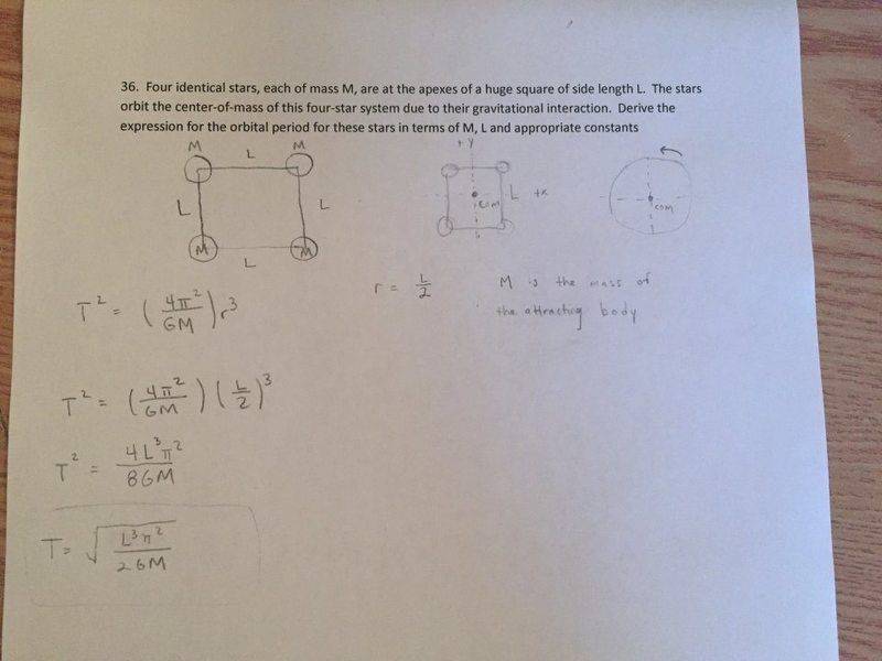

PAstudent
47
(In picture)[/B]
(In picture)
[/B]
PAstudent said:
(In picture)[/B]
(In picture)View attachment 91892 [/B]
The distance of each star from the c.o.m. of the system is not L/2. Each star in the group is located L/2 from the two stars immediately adjacent.
You start with the formula ##T^2=\Big( \frac{4 \pi^2}{GM} \Big)r^3## where ##M## is the mass of the attracting body.
But in your solution you use ##M## for the mass of each orbiting sun.
