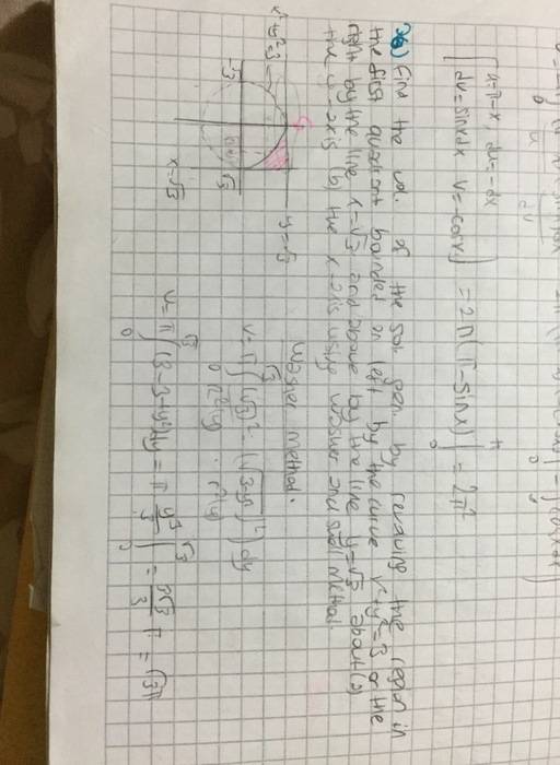

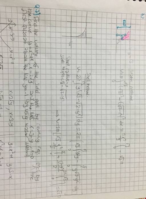

This is the main question.So I'm stuck at the b part
It says that the shell radius is (3)^1/2 - (3-y^2)^1/2 but i would only say (3-y^2)^1/2.Why do we say otherwise?
i would say the shell radius is (3-y^2)^1/2 but it's wrong

It was rather difficult to read. Moreover, it would have been helpful for you to have accompanied the images with more text explaining what you were trying to do here.
For using the shell method and revolving about the x-axis:
I would say the radius of the shell is y, the width is ##\displaystyle \ \sqrt{3}-\sqrt{3-y^2} \ ##, and the thickness is dy .
Thread closed as posting homework questions as images is not allowed per Physics Forums rules. elfinitty, if you want further help, please re-post in a new thread with the question as readable text. The Physics Forums LaTeX features can help you to format equations.
