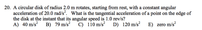

AfronPie
Attached.
Tangenital acceleration=r*alpha
3. The Attempt at a Solution
I thought it was just simply r*alpha=2*20=40 (choice A), but the answer key says choice B. I'm not really sure where I could have went wrong or its possible that there is a mistake in the answer key.
Any insight would be very helpful. Thanks.
Stick to answer A. Key's wrong.
Likes AfronPie
I think you are correct..
http://spiff.rit.edu/classes/phys211/lectures/tang/tang_all.html
Likes AfronPie
Thanks.
I calculate 79 m/s² for the centripetal acceleration (towards the center).
Likes Nidum and BvU
