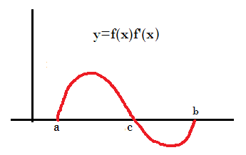

##f(x)## is a continuous and differentiable function. ##f(x)## takes values of the form ##^+_-\sqrt{I}## whenever x=a or b, (where ##I## denotes whole numbers) ; otherwise ##f(x)## takes real values. Also, ##|f(a)|\le |f(b)|## and ##f(c)=-1.5##. Graph of ##y=f(x)f'(x)##:
The number of rational values that ##f(a)+f(b)+f(c)## can take is?

##f(x)f'(x)=0## implies either ##f(x)## or ##f'(x)## or both are zero. At ##c## ##f'(x)## is zero since ##f(x)## is non zero. Hence, f(x) has a maxima or minima at ##x=c##.
Now, from ##a## to ##c##, either bothe the function and its derivative is positive or both are negative. Applying Rolle's theorem,
##{f'(k)}^2+f(k)f"(k)=0## since ##g(a)=(c)##.
But I don't seem to be getting anywhere.
Looking at the plot, between a and c, f(x) and f'(x) are either both negative or both positive. Since f(c) = -1.5, we should assume both negative. Then from b to c, f(x) and f'(x) should have different signs, and we know that f(c) is negative, so assume f(x) <0 f'(x) >0.

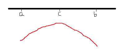

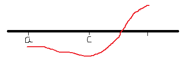

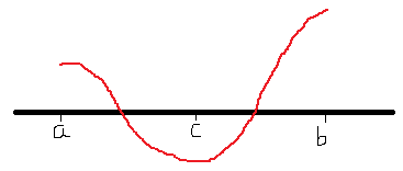

I am confused. Here are some plots for f(x) which are possible:
Why can't there be a root? The graphs are for y=f(x) and not f(x)f'(x). There are no roots for y=f(x)f'(x) in a<x<c
None of those look right to me. The curve given in the OP implies that in (a,c) f and f' have the same sign and in (c,b) they have the opposite sign.
But I do count three possibilities for the shape of f.

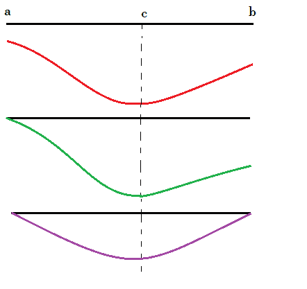

Here are the possible curves:
Right.
How about the original question? Not sure how much the diagrams help, but it's good to get them right.
