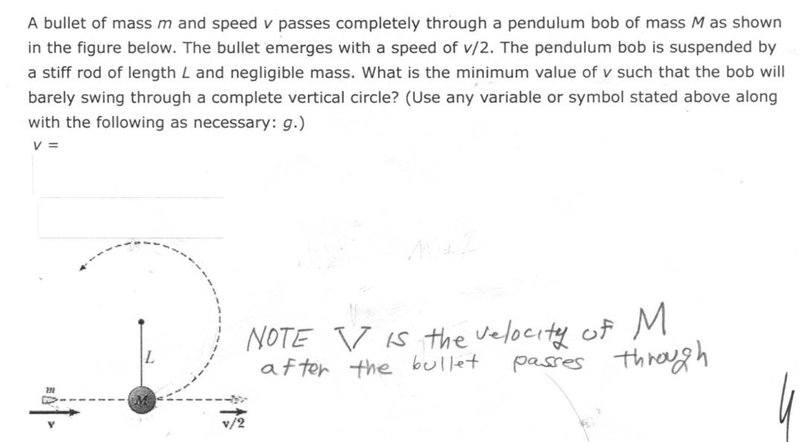

See attached diagram and statement of problem
Conservation of momentum ...
mv = MV + mv/2
mv/2 = MV
V = mv/(2M)
centripetal force...centripetal force equals weight at top of circle.
MV^2/L = Mg
V^2 = Lg
V = (Lg)^.5
Set V = V
mv/(2M) = (Lg)^.5
v = 2M(Lg)^.5/m
The answer is supposed to be v = 4M(Lg)^.5/m
I am off by a factor of 2 where did I go wrong?

Won't M slow down as it moves from the bottom to the top?
1. What is the speed at the top of the path when the bob just barely makes it?
2. Given you answer in 1, what is the centripetal acceleration?

This would be valid if the stiff rod were replaced by a string. As @kuruman noted, you need to reconsider what the required speed of M must be in order to barely make it over the top.

Think, is the motion of the bob with a constant centripetal force or variable centripetal force. In all situations energy has to be conserved so why not try it out?
