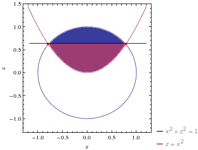

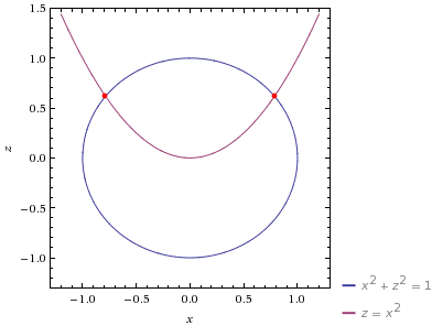

I have attached the xz-trace coordinates (in the plane y=0) so you can understand the limits. The yz-trace coordinates look the same. I've also attached an edited graph of the same, showing the 2 sections of volume that you need to find. Note that the vertex of the parabola is the origin.
To make it easier, you can use cylindrical coordinates to find the lower region and spherical coordinates for the upper region.

There is no need to work this problem in two parts, nor any need to use spherical coordinates. ##z## on the lower surface is ##z=r^2## and ##z## on the upper surface is ##z=\sqrt{1-r^2}##.$$
V=\int_0^{2\pi}\int_0^{\sqrt{\frac{-1+\sqrt 5} 2}}\int_{r^2}^{\sqrt{1-r^2}}r\, dz dr d\theta$$
Edit: Corrected upper limit for ##r##, accidentally left off the square root.
