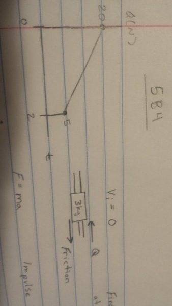

The 3kg collar is initially at rest and is acted upon a force Q which varies by the the graph shown. Knowing that the coefficient of kinetic friction is 0.25, determine the velocity of the collar at t = 1 s and t = 2s.
FΔt = mΔv
Ffriction = .25 x N
I know that the answer for b = 3.43 m/s, but I'm trying to think of how I would get there.
I thought about the impulse equation so I tried plugging it in. Since at t = 2, F = 5, and Δt = 2, I said
10 = 3(Vfinal - VInitial
where V initial would be 0. I get that the velocity at t = 2 is 3.33, which is close, but no cigar. I then thought about the the force of friction that would be acting in the opposite direction of Q, so I should subtract the two forces. I found that the force of friction is 7.3575 N. Once i subtract the two, I get a negative value, which I don't think is right. Any help would be much appreciated!
  • Handwritten sketch of a force-versus-time graph with axes labelled Q (N) and t, showing a line rising from 0 to 20 and then a sloped segment to 5 at t = 2; beside it, a 3 kg block with arrows for Q and friction, and the notes V_i = 0 and F = ma.

I don't understand the scale on the graph. The y=20 line seems to be only 3 times the height of the y=5 line.
When the calculated force of friction exceeds Q, there are two possibilities for the acceleration. What are they? (Note that you make a certain assumption when you calculate kinetic friction.)
