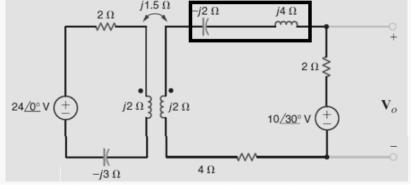

Find Vo
KVL, KCL
Mesh equations:
-24 + I1(2-j)-I2(1.5j)=0
I2(6+4j)+10<30degrees-I1(1.5j)=0
I1=8.69541+3.59557j
I2=-1.00284+2.00908j
How would I find Vo?

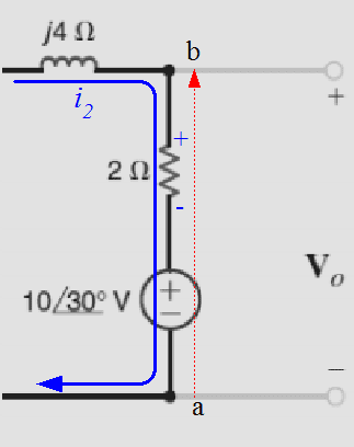

What you're doing in this instance is determining all the potential drops across the components along a path between two points where you wish to know their potential difference. The two points in question are where Vo is shown to be on your circuit. A handy path for that passes through the 10 V source and a 2 Ohm resistor.
So first you find the potential drop across the 2 Ohm resistor (the 10 V source is trivial). To do that you use the current flowing through the resistor. Pencil in the potential change polarity for that resistor on your circuit using your chosen direction for that current:
##i_2## flows through that resistor from top to bottom, hence the +...- indication as shown. Then do your "KVL walk" along the path (indicated by the red arrow from a to b), summing the potential changes as they are encountered.
I assumed Vo was the voltage at node B (your picture) which is: V(2ohm) + 10<30 OR I2*(-2j+4j)
Yes, it's the potential at node b with respect to node a. I don't understand where I2*(-2j+4j) comes from; I don't see a path from a to b where that would be true.

This is what I thought:
I see. But that is not a complete path from a to b. A complete path that includes those components would also include the transformer (both the secondary coil and the mutual inductance) and the 4 Ohm resistor. It has to be a complete, unbroken path.
