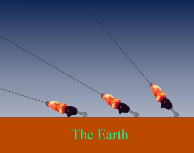

Good day :smile:
As you know there are a lot of projects for launching the payload into space by means of huge cannons, for example the http://quicklaunchinc.com/sharp" project.
Imagine that such cannon is ready to be used and can launch the payload with initial speed let’s say 8 km/sec, this is a bit more than value of Orbital Velocity at Low Earth Orbit. The cannon may be tilted towards Earth’s surface at various angles, such as 30º, 45º, 60º and etc:
Is it possible to calculate what will be payload’s speed when it leaves atmosphere at the altitude of 100 km? Of course if initial angle is 30º then the payload will have to cover more distance in air and loss in speed will be more, if that angle is 45º than the loss will be less….so, is it possible to calculate? :smile:

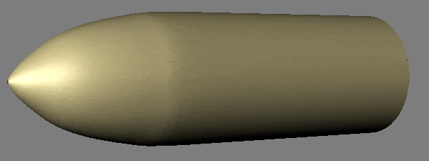

It would seem to depend a great deal on the aerodynamics of the payload "shell". What assumptions are you going to make about the size and shape of the projectile?

Actually I believe the minimum escape velocity for an object is 11 km/sec. And just off the top of my head you could do energy conservation to calculate its final velocity after air and gravity have performed work on the payload.
Shape: as I know the supersonic aircrafts/rockets (should) have narrow/tapered shape like cone, so the payload will have the same like this:
http://img841.imageshack.us/img841/9012/formf.jpg
As for size……is it important? In my case the diameter will be several meters, for example 5 meters, length-twice more, about 10 meters :smile: then what? Can we calculate something important based on these sizes?

Well, in this case we need to put the payload on the orbit around the Earth :smile: so, the trajectory will be tilted and not vertical.

A payload launched from Earth has an orbit that intersects with the surface of the earth. How do you propose to correct the orbit once the projectile is at altitude?
Anyway, I'd start with conservation of energy and the assumption that the projectile isn't in the atmosphere long enough for substantial drag-induced speed reduction. Unless you're at a steep angle, you're essentially out of the atmosphere in a few seconds. Even if you decelerated at 100g for 10 seconds, you'd only drop to 7 km/sec.

"...diameter will be several metres, for example 5 metres, length-twice more,"
I take it you are using a magnetic cannon or such, as building a 'conventional' gun barrel that diameter would be very difficult...
With the exception of short-barrelled mortars, the biggest guns fielded were ~ 80cm diameter and wore out after ~300 shots...

By means of its own rocket engines, they will fire in space :smile:
Yes, if the initial speed is high (10 km/sec or so) then the payload will leave the atmosphere soon, but still its speed will be reduced and I want to know how it is possible to calculate this loss, at least approximately.
From 8 km/sec? How did you calculate this?
