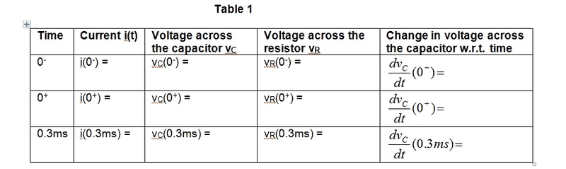

Hi I got this problem and have to fill out this table.
node analysis
time constant = RC
ic(t)= C dVc(t)/dt
I got few answers which i worked it out.
i (0-) = 0
Vc(0-) = 1.84
Vr(0-) = i (0-) * 10000
i (0+) = 0
Vc(0+) = 3.16
Vr(0+) = i (0-) * 10000
Am i right so far?
I don't know rest of them. the last column i know i have to use node analysis for that.
The problem description mentions two separate time intervals, a charging interval and a discharging interval. You haven't stated which interval is in play for the determination of the table values.
I understand but that's what it said... complete table 1.
Okay, so pick one of the intervals and state which one you've chosen (somehow I suspect that they want you to fill out the table twice, once for each interval...).
Hint: Before you make assumptions about Vc(0-) be sure to compare the time constant of the circuit to the given switching interval.
