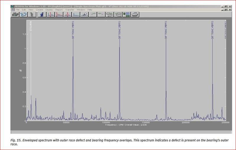

Vibration analysis is your most powerful bearing diagnostic. Fast Fourier Transform(FFT) tells you the frequencies present. It's applying high-tech to the old mechanic's stethoscope.
In 1974 a FFT analyzer ran on a PDP11 computer and with its signal conditioning equipment weighed a couple hundred pounds.
Small hand held FFT analyzers came about in late 1970's and seemed like something out of science fiction . Bentley Nevada was a pioneer but there are scores of companies in that business now so try a search. The early ones i knew of started around Knoxville Tennessee.
meantime here's a paper by an old line bearing manufacturer.
http://www.skf.com/binary/tcm:12-113997/CM5118/index.html
see 'bearing defect' spectra starting on page 20.
I saw my industry learn to use this technology in early 1980's. It's the way to go and is no longer expensive.
See if you can find a copy of Bentley's classic textbook "Practical Vibration Primer" .
