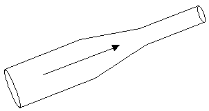

Most liquids can be assumed to be incompressible, since the Mach-number is much smaller than 1. That means that the density variations are negligible and from the relation between pressure p and density ρ,
<br /> p=c_s^2 \rho<br />
we see that the pressure in constant as well. Now, say that I look at a pipe with the following geometry:
From Bernoulli's equation we get that the pressure and velocity will be different between the large-radius part of the pipe and the small-radius part. How does this varying pressure conform with the constant pressure/density obtained from the equation of state?
The relation ##p = c_s^2\rho## is only meaningful for compressible fluids. In an incompressible fluid (which doesn't exist, but it is a useful approximation), the speed of sound ##c_s## would be "infinitely fast".

I see, I was being not very accurate in my OP, I admit that. OK, so starting all over again:
We can approximate many fluids as being incompressible, i.e. their density ρ is constant throughout the fluid. For our fluid we have the relation p = cs2ρ, where cs is the speed of sound in the fluid. Knowing this constant relation between ρ and p, how should I interpret the pressure changes that occur in Bernoulli's equation?
Now that has to be a valid question.
It's not only pressure which is changing in the flow. The velocities will be different at different points in the flow if the pressures are different.
All the Bernoulli relation is saying is that under certain assumptions, the total energy in the flow is constant from point to point. If pressure drops, then velocity must increase to maintain constant energy in the flow stream.

Thanks. But in my book (Frank White, Fluid Mechanics page 231) he says that the pressure changes Δp are roughly related to density changes Δρ as Δp=Δρ*cs2, where cs2 is the speed of sound squared. Knowing that density changes are negligible, this means pressure changes should be negligible too.
But this contradicts the Bernoulli equation and your post, basically. Where is my reasoning wrong?
The real fluid is compressible. Therefore it has a finite speed of sound.
A mathematical model that says the fluid is incompressible is approximate. If you have an approximate model, some of its predictions will be wrong.
The math of the incompressible model can not tell you the speed of sound in the fluid. Your attempt to get the speed of sound from the math is like asking "if ##y = 4x^2##, what is ##\frac{\partial y}{\partial 4}##"? If your model assumes that ##\rho## is a constant, then ##\frac{\partial p}{\partial\rho}## is meaningless.

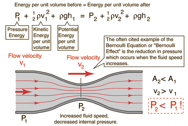

Bernoulli's principal says that the SUM of all types of pressure is constant
when the speed grows, static pressure drops.
But the SUM of pressures is always the same.
Yes, but p=c_s^2\rho is a local expression, it doesn't refer to a sum of pressures. That's what makes this strange
