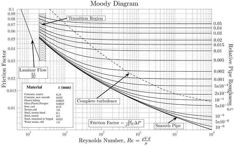

Given:
Water flows through a 15.24m long, 1.6cm diameter hose.
pressure at the outdoor tap = 275.8kPa
volumetric flowrate, Q = 7.5e-4 m^3/s (i.e. 7.5L for 10 seconds)
viscosity of water, μ = 0.001 Pa*s
density of water, ρ = 1000 kg/m^3
Look for: the roughness of the hose
Renolds number:
Equation for the Reynolds number: Re = ρvL/μ = vL/ν, with density ρ, velocity v, length L, dynamic viscosity μ and kinematic viscosity ν.
Darcy equation:
Darcy-Weisbach equation written as delta p equals f_D times L over D times rho V squared over 2, giving pressure drop in terms of friction factor, length, diameter, density and velocity.
Moody chart:
Moody diagram plotting friction factor against Reynolds number on log-log axes, with curves for relative pipe roughness from 0.05 down to 1e-6, a laminar flow line, a transition region and a dashed line marking complete turbulence.
I have calculated Renolds number = 7958 ==> turbulent flow
I used Darcy equation and found out the friction factor, f, is great than 1.
I am confused and stuck here.
I must have used the wrong formula or missed some important steps.
Please help me by providing some advice, double checking my work or giving some steps would be greatly appreciated!
volumetric flowrate = Q = 7.5e-4 m^3/s
D = diameter = 0.016m
velocity = V =volumetric flow rate/cross sectional area = Q/(pi*D^2*0.25) = 0.497 m/s
density = ρ = 1000kg/m^3
viscosity = μ = 0.001 Pa*s
Renolds number = Re = (density*velocity*diameter)/viscosity = 7958 > 2100 ==> turbulent flow
L = length of the hose = 15.24m
pressure at outdoor tap = ΔP = 275.8kPa
friction factor = f = (2*ΔP*D) / (L*ρ*V^2) = 2.34 ==> doesn't make sense and I'm stuck here.
Thank you very much, Chestermiller!
you are correct, V = 3.73 m/s,
problem solved.
