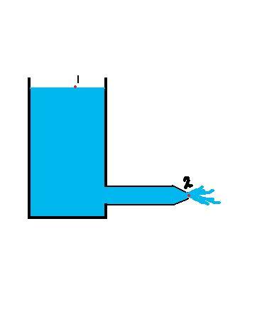

Hi friends
This isn't a homework poblem. However,I got this confusion when i was solving some problems.
Consider fluid flowing out of a tank as shown in figure attached.
Fluid moves out of pipe through a nozzle (generally used to accelerate the fluid). Now if we apply bernoulli's equation at point 1 and 2(shown in fig.) we find that fluid velocity comes out to be: V= (2gh)^1/2 (where h is height of tank above nozzle)
which is independent of nozzle diametre. That means if i remove the nozzle and fluid flows through a pipe of constant cross section, then also velocity will be same. This can be checked by applying bernoulli's equation.
But in general nozzle accelerates the fluid for same mass flow rate.
How will you explain this?
You lost me here. How does a nozzle accelerate the fluid? Where is the motive force?
This is just an estimate for the velocity. Strickly speaking it is applied only before the nozzle. Because inside the nozzle the flow has mean shear (vorticity is not zero), thus the flow is no longer potential and the bernoulli's equation does not apply.
P.S. do not read crappy wiki articles, read proper books.
Its accelerating the flow via the continuity equation. The force is coming in the form of reduction in static pressure.
Not so fast... the force is bouyancy, acting on the open container. If the container were sealed, there won't be any flow.
The nozzle does not *accelerate* the flow... re-direct, at best.
If you have a nozzle, the flow velocity coming in is less than the flow going out (again, just look at the contiunity equation). So the flow had to accelerate. Also, the force acting on the open container is not bouyancy, it is hydrostatic. :smile:
To be more precise, let's just look at what the math says:
[tex]A_i V_i = A_e V_e[/tex]
where e - exit, and i - inlet. Then clearly:
[tex]V_{e} = \frac{A_i}{A_e}V_i[/tex]
But by definition the ratio of the areas is > 1 for a nozzle. Hence the flow speeds up. By Bernoulli, the static pressure goes down. This causes a static pressure gradient across the nozzle (a bouyancy force), which pushes the nozzle in the axial direction inline to the flow contraction. Take a garden hose and put your thumb over it, you will feel this force as it pushes your hand forward.

R Power said:
so what's the solution to my problem?
You applied your analysis incorrectly. Go back and do it over again, and have point two just before the nozzle, and a new point three just after the nozzle. See what you get.
if i take point 2 just before the nozzle and then i apply bernoulli, i can't find velocity at 2 because i don't know pressure at 2.
Can u help
Can u help
I tried working this problem out, here is what I would do. Make three points, 1 (top of the tank), 2 (bottom of the tank), 3 (nozzle entrance), 4 nozzle exit.
I would solve this by finding the pressure at point 2, which is just hydrostatic. That will be the total pressure (with zero velocity). Use that as your inlet condition to the nozzle (3), and find the flow velocity at (4).Side note: I is capitalized, and u is spelled "you". The first letter of a sentence is capitalized, and the sentence ends in a period.
Are you sure static pressure at points 2 and 3 would be same?
Since fluid moves from 2 to 3 and since elevation remains constant, so all the pressure energy in converted into kinetic energy and that's why velocity increases in pipe and so static pressure decreases there, so pressure at 2 won't be equal to that at 3.
Strictly speaking, no the pressure won't be the same (your observation is correct). I neglected, and thinking twice about it you probably shouldn't. Try writing out the equations, (with the pressure as an unknown). And then see if you can eliminate it later on. I.e, write the equations from 1-2, 2-3, 3-4. Then see if things will drop out. If you write said equations here, we can try and look at them together.
1-2 pgh = P2 (p = density of water) (P2 = pressure at 2)
2-3 P2 = P3 + [0.5 * p * (V3)^2] (V3 = velocity at 3)
3-4 P3 + [0.5 * p * (V3)^2] = 0.5 p (V4)^2
come on cyrus i have wrote the equations , now help me !
I am going to give you one more reply
if we assume the liquid has no viscosity (ideal fluid) than bernulli is applied before and after the nozzle. In this case there is veolicty slip at the wall, it does not go to zero like in reality. Then the velocity before the nozzle and after the nozzle not going to change. By nozzle here I mean a tube of constant cross section like in your figure. If the cross section does change, then the velocity will increase in case the cross section is shrinking and vice versa like Cyrus wrote.
However, in reality there is no slip at the wall, slowly boundary layer will be develloping, the flow in the middle of the tube will accelerate. Also, since there will be definitely vorticity in the tube, bernulli is not applied. I am not going to go into details here, but there are many reasons why velocity in the outlet not going to be the same as near the inlet besides just varying cross section. Meanwhile, provided the nozzle is of constant diameter and not very long, this estimate from bernullli equation is reasonably correct.
