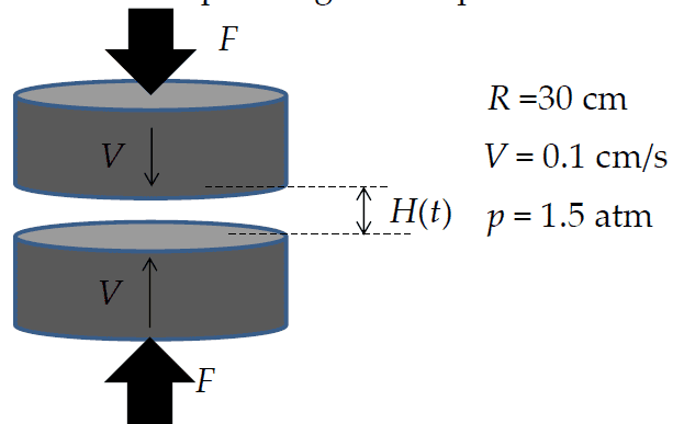

Diagram of two cylindrical pistons facing each other with a gap H(t) between them, large arrows labelled F pushing inward from top and bottom, arrows labelled V showing each piece moving toward the gap, and labels R = 30 cm, V = 0.1 cm/s, p = 1.5 atm.
The initial separation of the pistons is 2cm. They are submerged in water at room temperature.
I need to calculate the work required to have two pistons touch, find the volumetric flux of the water as a function of time, and the force at a given time

Is my solution for force correct? I'm not sure of the integration I need to do for work and flux from here. How do I find the force as a function of time?

No. The p0 should not be inside the parenthesis. In fact, it should not be in there at all; you forgot to include the force of the water pushing down on the piston from the top. Also, you should have used the pressure at z = H to get the force on the piston, and not at arbitrary z. I didn't check the rest of your integration. Also, your equations are hard to read because you don't use Latex.
What is H as a function of time?

The initial gap between the two pistons is 2cm and the velocity of each piston is 0.1cm/s, so I'm taking H(t) to be
[itex]H(t)=2cm-2*0.1cm/s*t[/itex]
The diagram looks incorrect. From your equations for the velocities, it is obvious that H is half the distance between the pistons (and z is measured upward from the center-plane). So, H = 1 - (0.1) t

Oooops. My mistake. Sorry. That's what I get for trying to do it in my head.
You should mention to your professors about that error in the figure regarding H. Another issue is that the platens are immersed in water. So, unless the platens are neutrally buoyant, they are going to contribute to the force, and the bottom force is going to differ from the upper force. So, I guess you need to assume that they are neutrally buoyant.
