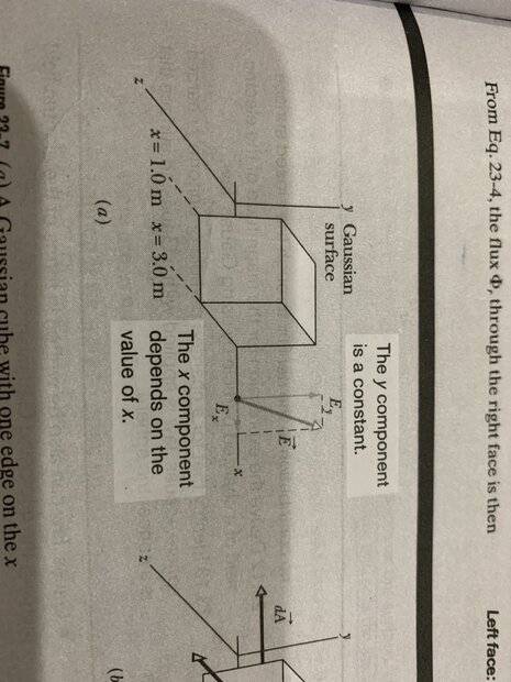

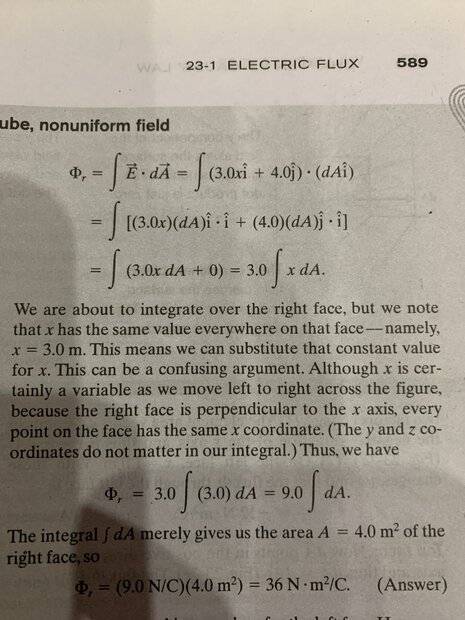

The non uniform electric field through a cube is given by E= 3xi^+4j^. We need to find flux of a surface of a Gaussian cube. The surface that we need to find for is at x= 3 meter.
Phi= int of(vector E. vector dA)
Phi = int of (3xi^ + 4j^).vector dA = 3 int of(xdA)
Now we put x= 3 and we get at last 36 N m^2/C.
I am getting confused why E is a fuction of x. How can that be? How can we represent the E and position x on the same coordinate system. Is it right ? Because we know distance is inversely proportional to E. how is it multiplied like that?

I am asking precisely why E and position x are in one coordinate system. How is x multiplied like that. How is this non uniform field? Where is the source located precisely? Can we represent E as a function of x? We know square of x is present in the formula of E in bottom. How did it end up there like that ?
When one writes ##\vec E=3x~\hat i+4~\hat j,## this means that there is a vector field such that the electric field vector has different values at different points in the xy-plane. Anywhere on the y-axis, the y-component is the same. On the x-axis, the x-component increases linearly with distance. Here are some values
##\vec E= [0,4]## at the origin.
##\vec E= [3,4]## at point [1,1].
##\vec E= [-3,4]## at point [-1,-6].
##\vec E= [4.5,4]## at point [1.5,10].
Where the source is located and what shape it has is of no importance. Once you know the field everywhere in space, you have all you need to answer electrostatic questions about what's going on in that region of space. You can find the flux through a surface, you find the trajectory of a charged particle placed in that field, and so on.

It is a non-uniform field because its magnitude changes as x changes. A uniform field would have the same magntiude (and direction) at every point in space.
The source isn't located precisely - it is spread-out, filling all of 3D space, with a charge density that is a function of position.

I don’t know if this helps, but give it a try…
We are given ##\vec E=3x\hat i+4\hat j + 0 \hat k##
We can use this to find the electric field components at any point in space. For example (with coordinates in metres and electric field strength in V/m):
At point ##(-2, 0, 10), \vec E = (-6î + 4î + 0k̂)##
At point ##(-1, 7, 0), \vec E = (-3î + 4î + 0k̂)##
At point ##(0, 2, 19), \vec E = (-0î + 4î + 0k̂)##
At point ##(1, -8, 0), \vec E = (3î + 4î + 0k̂)##
At point ##(2, -3, 98), \vec E = (6î + 4î + 0k̂)##
The field at any point (x, y, z) has:
zero z-component;
a y-component of 4 V/m;
an x-component which is proportional to the point’s x-coordinate (in fact the field's x-components is numerically 3 times the point's x-ccordinate, so in the expression '3x', the '3' has units of V/m² and the 'x' has units of m).
This is an example of a vector field. The magnitude and direction of the field at any point is a function of the point’s coordinates. This field is the result of some (unknown) continuous distribution of charge in space.
