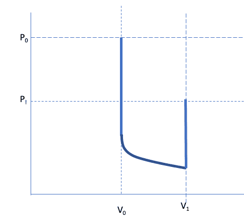

See my graph for B in the previous post. Your points should not be evenly spaced horizontally. I didn't ask you to change the numbers on the scale. I asked you to change the scale itself. Double click on the x axis. you should get a dialog box with a selection called scale, and showing linear. Just change the selection to Log.
B, C, D, and irreversible look correct, but not A. Pl\ease recheck your calculation for A. A should be lower than B.

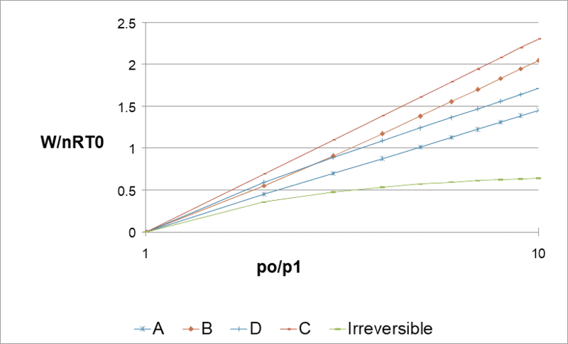

guhag said:
There was a typo in the sign (sigh!) in calculations for process A. Also, I am using Freeoffice and not excel, so things took time to figure out. Apologies for the delay.
I have attached my working and the stacked graphs. Thanks and have a good weekend.
The graphs are definitely wrong. They should all show the same value of W=0 for Po/P1 =1. The data in the table also looks incorrect. Dimensionless W for C is ln(V1/Vo). Dimensionless W for D is ##\frac{T_1}{T_0}\ln(V_1/V_0)##. V1/Vo is not equal to Po/P1. I haven't checked your data for A. The data for A and Irreversible is correct.

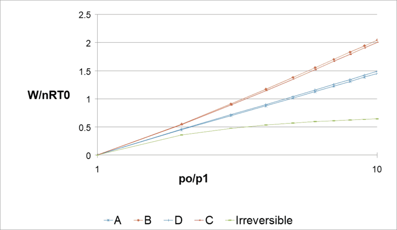

PROCESS C
1. Isothermal expansion at temperature To from Vo to V1
2. Isochoric cooling at volume V1 from To to T1
I got this for W(total)= RT0ln(V1/V0). For the overall process, V1/V0 = (Po/P1) * (T1/T0). For the 1st step,V1/V0 = (Po/P1) . Since work for step 2 =0, W(total) = W1, hence I used V1/V0 = Po/P1 from the 1st step. Why is that not correct?
Similar case with process D.

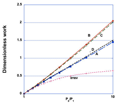

The results in these figures for part (b) show that the reversible work between the initial and final states of our system in this focal problem depends on the reversible path we select. So far we've seen that, for all the reversible paths we've looked at, the reversible work exceeds that actual irreversible work. Do you think that this holds in general, or is it possible that there are reversible paths that give less work than the irreversible path? If so, can you propose any?

I got it, thanks ! Here is the corrected graph for all the processes, finally it seems to match with yours !
  • #42
I’m
Excellent. Next, please consider the questions I posed in post 39.

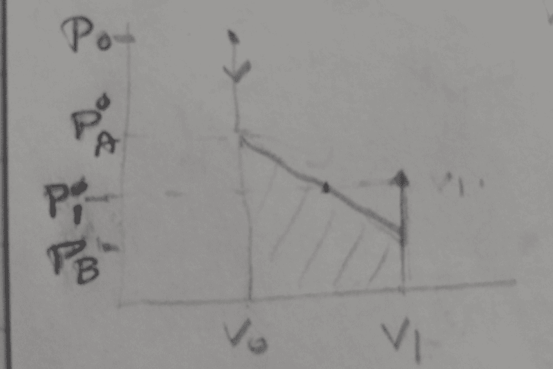

How did you came up with this example, I wonder? I don't mean to disrupt your flow of thought (so you can check the question below, when you see fit):
Another question: I tried to chart this process out on a P-V diagram to see if I could deduce this graphically, for instance BUT was not successful.
As an exercise within an exercise ad infinitum :), the state variables for each of these steps I calculated are (to plot them in the P-V diagram):
1. (P0,T0,V0) to (Pa, T0/4, Vo) where Pa = P0/4
2. (Pa, T0/4, Vo) to (P
b,T0/4, V1) where Pb* V1 = Pa * V0 = nRT0/4
3. (Pb,T0/4, V1) to (P1,T1, V1) where Pb = (P1/T1) * (1/4)
a. Are these states of the system correct or did I mess them up?
b. If they are correct, I wonder (with appropriate reservations on my rusty math skills) why am I not able to prove this geometrically?

I was trying to plot the process E on the P-V diagram and calculate the area to see how it compared with other reversible processes (A-D). I will try this on my own and ask you if I don't make any headway.
