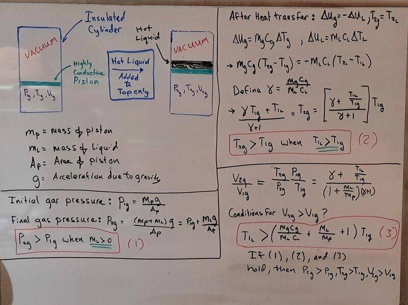

I think I might have a physical scenario that would give these results. ChesterMiller will correct me if I am wrong, but this is what I came up with for a single process.
The Setup: Consider a well-insulated, vertical cylinder with tight-fitting piston made from very high conductivity material. The piston is situated some distance from the "bottom" of the cylinder, and held up by the pressure in the ideal gas below. Above the piston is vacuum. Call this state 1, and here the gas has ##P_{1g}, \; V_{1g},## and ## T_{1g}##.
The Process: A very hot liquid is injected into the vacuum above the piston, partially filling the void (leaving plenty of room for expansion). This results in extra mass on the piston, so we know the pressure in the gas rises and therefore ##P_{2g}>P_{1g}##. As the gas and the liquid come to thermal equilibrium, the temperature of the gas will rise while that of the liquid falls, resulting in ##T_{2g}>T_{1g}##. The question is: under what conditions will the final volume of the gas be larger than the initial volume? Let's further say that the mass of the gas and liquid are both 1 unit.
The Math: Here is where I may make a mistake, as I don't have any of my thermo books around and my algebra skills are rusty. ChesterMiller will, hopefully, point out any mistakes and correct as needed.
##P_{1g} = \frac{m_p g}{A_p}##
##P_{2g} = \frac{( m_p+1) g}{A_p}##
Clearly ##P_{2g}>P_{1g} ##.
For the temperature changes,
##\Delta u_g = C_{vg} \Delta T_g##
##\Delta u_L = C_{vL} \Delta T_L##
Also, ##\Delta u_g = -\Delta u_L## and ##T_{2g}=T_{2L}##. If we define the ratio ##\frac{C_{vg}}{C_{vL}} = \gamma##, then we can rearrange the above relations into the following:
##\frac{\gamma T_{1g} + T_{1L}}{\gamma+1}=T_{2g}##
Clearly, ##T_{2g}>T_{1g}## when ##T_{1L}>T_{1g}##. So we only need to make the liquid hotter than the gas at the start, as expected.
Finally, we want to know what conditions will give ##V_{2g}>V_{1g}##, and whether they are possible to achieve.
So, when is ##V_{2g}>V_{1g}##? When ##\frac{V_{2g}}{V_{1g}}>1##, of course.
##\frac{V_{2g}}{V_{1g}} = \frac{T_{2g}P_{1g}}{T_{1g}P_{2g}}##
If we plug the previous results for pressure and temperature into the volume ratio requirement, we get (barring mistakes!) the following:
##\frac{\frac{T_{1L}}{T_{1g}}-1}{\gamma+1}>\frac{1}{m_p}##
This seems entirely possible. We only have to choose the temperature appropriately given the initial temperature of the gas and the mass of the piston. It seems this is a one step process that meets the requirement on the final state of the gas.
HTH

I am not sure why my previous attempt was unclear to some. I may have made a mistake (or many) somewhere, and that could be the reason. Please let me know where the error is if that is the case.
This is meant to help with a "concrete" example. I believe all three conditions are possible to meet, thus the second state is reachable from the first state.
Handwritten whiteboard derivation for a gas in an insulated cylinder with a conductive piston, where hot liquid is added on top, showing equations for final gas pressure, temperature, volume, and conditions for volume increase.
This is meant to help with a "concrete" example. I believe all three conditions are possible to meet, thus the second state is reachable from the first state.View attachment 289727

Chestermiller said:
So you are neglecting any vapor from the liquid that is formed in the upper chamber? isn't this the same as putting a weight on top of the piston and placing the cylinder in contact with a constant temperature reservoir at the same temperature that the liquid would have?
Yes. If you think neglecting the vapor is untenable, we could replace the liquid with a hot solid.
It is and it isn't the same. In the process you suggest, one would perform two actions: place a weight and add heat. In the process I suggest, these are accomplished in one action. I believe that was the requirement.
