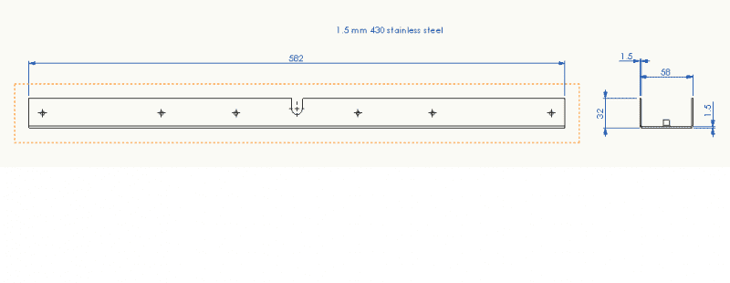

How much force is needed to bend a fixed beam channel by 4mm at 'F'?
The discussion centers on calculating the force required to bend a fully fixed beam channel by 4mm at a specific point, denoted as 'F'. Participants emphasize the necessity of additional information, such as the beam's dimensions, material properties, and the specifics of the structural discontinuity present at mid-span. The consensus is that traditional beam formulas are inadequate due to the channel section's unique characteristics, and a numerical simulation is recommended for accurate results.
