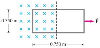

A rectangular loop of wire is being pulled out of a magnetic field at a constant speed of 4.42 m/s, requiring a calculation of the force needed for this action. The magnetic force acting on the loop opposes the applied force due to Lenz's law, which states that the induced magnetic field will act in the same direction as the applied force. The discussion highlights the importance of understanding the direction of the magnetic force, which varies as the loop moves through the field. It is clarified that while forces act on different segments of the wire, only specific segments contribute to the net force in the direction of motion. The realization that the right side of the rectangle is outside the magnetic field eliminates the confusion regarding forces acting in that direction.

A force acts on a rectangular loop of wire, pulling it out of a magnetic field. Calculate the force required to pull the loop to the right at a constant speed of 4.42 m/s.
B = 0.44 T
l = 0.350 m
v = 4.42 m/s
R = 0.356 ohms
Fmagnetic=I*l*B
I=(emf)/R
emf=B*l*v
1. As we pull the loop, the area exposed to the magnetic field will decrease.
2. Per Lenz's law, this means that the induced magnetic field will 'strengthen' the magnetic field and will act in the same direction, into the page.
3. So current will flow clockwise.
5. The 'right' way to do the problem seems to be fairly simple - just plug in the formulas I've already given, assume that Fmagnetic will oppose Fapplied and solve for Fapplied.
This gave me the right answer, but I'm now looking for a reason why the magnetic force will oppose the applied force. How do we find the direction of magnetic force? It's ILvector x Bvector, where Lvector is in the same direction as I is - the problem is that the vector will change directions four times as it moves through the loop. How do we know which one of these to cross with B? Wouldn't the magnetic force act on all of the segments of wire - i.e. there'd be a force pushing up on the rectangle, down on the rectangle, one pushing the rectangle to the left, and one pushing the rectangle to the right.
I seek understanding! Help me out!
Your understanding is almost completely correct. There's a force pushing up on the rectangle, down on the rectangle, and pushing the rectangle to the left. There's no force pushing it to the right because the right side of the rectangle is outside of the field.
I can't believe I was missing that the entire time - thanks so much!
