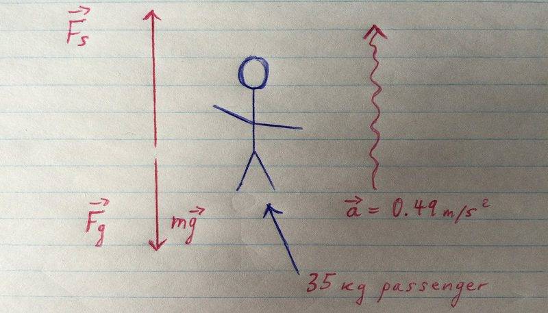

I don't know why the OP never replied, but I've been solving the same question, and my calculations for solving the force normal acting on the 35 kg passenger:
Upward net acceleration: anet=0.49m/s2
Net force on the passenger: Fnet=Fs+mg
Newton's Second Law: Fnet=manet
Fs+mg=manet
Fs=manet-mg
Fs=35 kg x (0.49m/s2[up] - 9.8m/s2[down])= 35 kg x (0.49m/s2[up] + 9.8m/s2[up])
Fs= 35 kg x 10.29 = 360 N [up]
Therefore, the passenger will feel heavier during this period of time as the elevator accelerates upwards.
And as for the free-body diagram with all the forces affecting the 35 kg passenger:

Your calculations are fine, except that there is a flaw in the question statement which invalidates the answers. The cable tension is given as 1.20x104N, so that means anything from 11950N to 12050N. Propagating that through the steps leads to an acceleration anywhere from 0.44ms-2 to 0.54ms-2.

Therefore, if I have understood you correctly, what you are saying is that 0.50m/s2 is the most accurate acceleration of the elevator? And that 12000 N might be the most accurate upward force? Would you mind reiterating?
0.5, not 0.50
Which upward force? The tension in the cable is given as 1.20x104N. There is no better way to express that.
haruspex said:
0.5, not 0.50
The cable exerts an upward force. I concur with you on the 0.5m/s2
After redoing the calculations I came with the results:
The velocity of the elevator 12.0s after the passengers enter it is 6.0 m/s2
The force normal acting on the 35 kg passenger will be 360.5 N
It isn't a big difference, but could very well end up being the exactly correct response to the question, due to the faults. Thank you for looking over my work on this question, I appreciate it. :smile:
