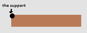

I'm wondering this for any object with moment of inertia I, but I'll ask this question for a rectangle for simplicity and I'm sure I can extend it to general objects.
Say we have a rectangular object (with mass m, height h, and width L) that is attached to a wall by some sort of point support exactly at its corner. If we hold it horizontally then let it go and swing, what is the force that the support exerts on the ruler from right after we let go as it swings? Here's a picture:
Moment of inertia of this rectangle: [itex]\frac{m(h^2 + w^2)}{12} + m((h/2)^2+(w/2)^2) = \frac{m(h^2+w^2)}{3}[/itex]
I was thinking about concentrating the mass into a point mass at the location of the rectangle's center of mass. This would be like a simple pendulum with starting position at angle [itex]θ[/itex] below the horizontal, where [itex]θ=\tan^{-1}(h/w)[/itex]. There would be a force of mg downward, which has a component of mg*sin(θ) in the direction of swinging and a component of mg*cos(θ) pulling on the "string" of the pendulum. The force that the support supplies, in return, would be opposite to and equal in magnitude to this pull. I'm not so sure this is correct though...

To do this, I'm thinking that the "lever arm" is the the line segment from the pivot point to the center of mass. The force due to gravity perpendicular to this lever arm is mg*sin(θ), as stated in my first post. So, the torque should be [itex]L(mg\sin{θ})[/itex] where [itex]L = \sqrt{h^2 + w^2}[/itex] and [itex]θ=\tan^{-1}(h/w)[/itex].

With the moment of inertia, I can figure out the motion of this rectangle. How does that relate to the force that the pivot supplies? Does it supply a force equal to the component of the force of gravity on the rectangle, that is perpendicular to the component in the direction of the swinging motion?
A component of the pivot's force will certainly do that. What we know about the initial motion of the centre of mass of the ruler is that it will maintain a constant distance from the pivot. The net force in that radial (diagonal) direction is therefore zero. But the force from the pivot will also have a component perpendicular to that radial line. Together with the corresponding component from gravity this will provide the torque necessary for the angular acceleration. Relating the angular acceleration to the linear one should give you enough equations to solve it.
Calculating the torque around the pivot point also works. That gives you the angular acceleration, and the linear acceleration to add to that must be that which holds the pivot point still. Then you can figure out what force at the pivot point when combined with gravity produces that linear acceleration. The two methods are equivalent.

The torque due to the component of gravity perpendicular to the radius is [itex]mgL\sin{θ}[/itex]. Since [itex]\sin{θ}=\frac{w}{\sqrt{w^2+h^2}}[/itex] and [itex]L=\frac{\sqrt{w^2+h^2}}{2}[/itex], the torque is therefore [itex]\frac{mgw}{2}[/itex].
This torque is equal to [itex]Iα[/itex] and [itex]I=\frac{m(w^2+h^2)}{3}[/itex]. So, [itex]α=\frac{3gw}{2(w^2+h^2)}[/itex].
[itex]a = αL = \frac{3gw}{2(w^2+h^2)}*\frac{\sqrt{w^2+h^2}}{2}[/itex]
[itex]=\frac{3gw}{4\sqrt{w^2+h^2}}[/itex]
The acceleration from gravity, [itex]g\sin{θ}=\frac{gw}{\sqrt{w^2+h^2}}[/itex] is larger than [itex]a[/itex] found just above! So, I'm thinking that the pivot supplies a force in the opposite direction to make the net acceleration [itex]α=\frac{3gw}{4(w^2+h^2)}[/itex]
This force is [itex]m(\frac{gw}{\sqrt{w^2+h^2}}-\frac{3gw}{4(w^2+h^2)})=\frac{mgw}{4\sqrt{w^2+h^2}}[/itex]
So, my conclusion is that the force from the pivot is in two components: the first is in the radial direction (which makes the radial net force 0). This force has a magnitude of [itex]\frac{mgh}{\sqrt{h^2+w^2}}[/itex], which is the radial component of force due to gravity.
The other component is perpendicular to the previous component. This was found to be [itex]\frac{mgw}{4\sqrt{w^2+h^2}}[/itex].
Is my thinking correct?
hyperddude said:
The torque due to the component of gravity perpendicular to the radius is [itex]mgL\sin{θ}[/itex]. Since [itex]\sin{θ}=\frac{w}{\sqrt{w^2+h^2}}[/itex] and [itex]L=\frac{\sqrt{w^2+h^2}}{4}[/itex], the torque is therefore [itex]\frac{mgw}{4}[/itex].
A divisor of 2 has become 4 in there somewhere.
It's easier just to say the line of action of mg is distance w/2 from the pivot, so the moment is mgw/2.
This torque is equal to [itex]Iα[/itex] and [itex]I=\frac{m(w^2+h^2)}{3}[/itex]. So, [itex]α=\frac{3gw}{16(w^2+h^2)}[/itex].
2, not 16.
[itex]a = αL = \frac{3gw}{4(w^2+h^2)}*\frac{\sqrt{w^2+h^2}}{4}[/itex]
[itex]=\frac{3gw}{16\sqrt{w^2+h^2}}[/itex]
4, not 16.
The acceleration from gravity, [itex]g\sin{θ}=\frac{gw}{\sqrt{w^2+h^2}}[/itex] is larger than [itex]a[/itex] found just above! So, I'm thinking that the pivot supplies a force in the opposite direction to make the net acceleration [itex]α=\frac{3gw}{16(w^2+h^2)}[/itex]
This force is [itex]m(\frac{gw}{\sqrt{w^2+h^2}}-\frac{3gw}{16(w^2+h^2)})=\frac{13gw}{16\sqrt{w^2+h^2}}[/itex]
The other component is perpendicular to the previous component. This was found to be [itex]\frac{13mgw}{16\sqrt{w^2+h^2}}[/itex].
The noted numerical errors aside, yes.
Oh, good catch. No wonder the rest of my problem wasn't working out. Thanks!
