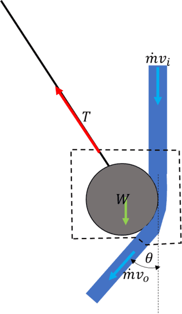

In x-coordinate direction
$$T\sin(\beta )=\frac{\dot{m}^{2}\sin(\theta)}{\rho A_{o}}$$
$$T=\frac{\dot{m}^{2}\sin(\theta)}{\rho A_{o}\sin(\beta )}\rightarrow (5)$$
In y-coordinate direction,
$$T\cos(\beta )-W=\frac{\dot{m}^{2}}{\rho A_{i}}-\frac{\dot{m}^{2}\cos(\theta)}{\rho A_{o}}\rightarrow (6)$$
Substitute (5) into (6),
$$\frac{\dot{m}^{2}\sin(\theta)\cos(\beta )}{\rho A_{o}\sin(\beta )}-W=\frac{\dot{m}^{2}}{\rho A_{i}}-\frac{\dot{m}^{2}\cos(\theta)}{\rho A_{o}}$$
$$\frac{\dot{m}^{2}\sin(\theta)}{\rho A_{o}\tan(\beta )}-W=\frac{\dot{m}^{2}}{\rho A_{i}}-\frac{\dot{m}^{2}\cos(\theta)}{\rho A_{o}}$$
$$\frac{\dot{m}^{2}\sin(\theta)}{\rho A_{o}\tan(\beta )}-W=\frac{\dot{m}^{2}}{\rho }(\frac{1}{A_{i}}-\frac{\cos(\theta)}{\ A_{o}})$$
$$\frac{\dot{m}^{2}\sin(\theta)}{\rho A_{o}\tan(\beta )}=\frac{\dot{m}^{2}}{\rho }(\frac{1}{A_{i}}-\frac{\cos(\theta)}{\ A_{o}})+W$$
$$\frac{\dot{m}^{2}\sin(\theta)}{\tan(\beta )}=\frac{\dot{m}^{2}\rho A_{o}}{\rho }(\frac{1}{A_{i}}-\frac{\cos(\theta)}{\ A_{o}})+W\rho A_{o}$$
$$\frac{1}{\tan(\beta )}=\frac{\dot{m}^{2}\rho A_{o}}{\dot{m}^{2}\rho\sin(\theta) }(\frac{1}{A_{i}}-\frac{\cos(\theta)}{\ A_{o}})+\frac{W\rho A_{o}}{\dot{m}^{2}\sin(\theta)}$$
$$\tan(\beta )=\frac{1}{\frac{\ A_{o}}{\sin(\theta) }(\frac{1}{A_{i}}-\frac{\cos(\theta)}{\ A_{o}})+\frac{W\rho A_{o}}{\dot{m}^{2}\sin(\theta)}}$$
$$\beta =\arctan[\frac{1}{\frac{\ A_{o}}{\sin(\theta) }(\frac{1}{A_{i}}-\frac{\cos(\theta)}{\ A_{o}})+\frac{W\rho A_{o}}{\dot{m}^{2}\sin(\theta)}}]$$ I am not sure if there is a nicer way to express ##\beta##

  • #107
erobz said:
I suspect it's not a trivial problem to solve theoretically. But experimentally, you should be able to find some functional relationship between the outflow angle and the mass flowrate. you have to measure ( control) incoming flowrate, and measure the angle of deflection.
You are going to be working with a control volume that is something like this:
And you apply Reynolds Transport Theorem - "The Momentum Equation" in fluid mechanics.
Which says for steady flow with uniform velocity distribution (one inlet-one outlet):
$$ \sum \vec{F} = \dot m \vec{v_o} - \dot m \vec{v_i} $$
Can you teach how to simplify RTT to this formula please
  • #108
printereater said:
Hi, I just saw your edit. How do we know that that force is cancelled by the pressure of water
Examine the boundary of the control volume... I've already explained this to you. Atmospheric pressure acts over the entire boundary with the possible exception of the small areas inside the fluid jet as it enters and exits the control volume. We have also assumed the fluid jet experiences negligible change in pressure between inlet\outlet. There is simply no room for an unbalanced pressure force term.
  • #109
well if it wasn't cancelled by the pressure from water it would keep pushing the ball and the ball would exit water from the other side but this doesn't happen. @erobz said that the water is at atmospheric pressure but I think this is kind of wrong, the water pressure at the interface with the ball must be a bit bigger than the atmospheric pressure so that it cancels the force from the atmospheric pressure on the other side of the ball, and also provides a force that cancels the net force from the tension and weight.
  • #110
You are talking about microscopic precision though. The pressure and velocity distributions are also nonuniform all throughout this flow and the flow is accelerating as it rounds the sphere. Its viscous flow over an unspecified spherical boundary in a vertical gravitational field. Its troubles me that this very small pressure difference over very small areas stands as "the theoretical issue" here...
I don't think going into all this helps the OP understand how a control volume is analyzed.
  • #111
Hmmm, ok not sure about the pressure of water on the interface it would be more correct to say that the sum of the forces is zero since we are at equilibrium. The (vector) sum of the forces is the force from the atmospheric pressure, the tension, the weight, and the force from water. Not sure how exactly they are cancelled , my guess was as what i say in post #109
  • #112
erobz said:
Its troubles me that this very small pressure difference over very small areas stands as "the theoretical issue"...
Sorry what exactly do you want to say here?
  • #113
