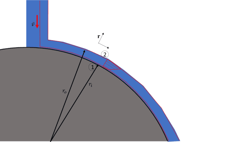

  • On the ball: The total force from water on the ball balances the sum of tension and weight and the atmospheric pressure force (on the clean side of the ball)
  • On the water beam: The sum of the atmospheric pressure force on water beam and the force from the ball on water beam causes the curvature of water beam.
What do you think?
I think viscosity is the key player. I don't believe the flow pressure significantly deviates from atmospheric. Just my opinion, but examine the actual experiment control volume ( not my crude diagram):
The thickness of the jet is reduced to a film around the ball. The outside boundary of the flow is atmospheric. The inside (where the ball is touching it) is just a fraction of a millimeter away. I simply don't believe there is a massive pressure gradient hidden there. What I believe is there is friction or surface tension grabbing the flow and distributing it, and changing its direction.
If you are looking at just the flow enclosed as the cv, I have trouble drawing a thin enough boundary around it. It seems unlikely the pressure significantly changes across its boundary.
In my opinion, no friction (viscosity) and\or surface tension, no more effect.

They are explaining how the transient stage initiates. What has been done here is the steady state solution (i.e. once the ball is immersed in the fluid stream and comes to rest).

I would like to discuss this with anyone that is still listening? They try to invoke Bernoulli's, and say that the pressure is lower in the moving air by dint of it simply being in motion. They are acting as if energy is conserved when Bernoulli's is called into action, but it clearly isn't. Work is being done on the air by the fluid jet, there is an external force acting on the air. The fluid jet is grabbing air (via friction), pulling it down at the interface with the jet as it falls. It's not as if the air had a certain energy and spontaneously changed its velocity, demanding a change in pressure because nothing else is able to change in the equation (no remaining energy reservoirs to trade energy with). The energy of in the air necessary to transition to higher velocity comes from friction with the fluid jet.
The way I see it, we do not need a pressure gradient to describe this force that manifests. Air being dragged by the fluid jet, sticks to the ball and is deflected, the same as the water jet. The force would manifest as a reaction to its rate of momentum change, just as the water does, albeit much smaller (the object must be quite close to the fluid jet for this to initiate).
What am I missing?

Another way to see this is that though we are at equilibrium we say $$\sum F=\dot m \vec{v_o}-\dot m\vec{v_i}\neq 0$$ though since we are at equilibrium we should set $$\sum F =0$$.
It seems to me that regarding the ball, the force from the atmospheric pressure minus the force from the water at the water interface equals the term $$\dot m \vec{v_o}-\dot m \vec{v_i}$$ so that if we transfer this term to the other side of the equation we can include it inside the forces and write $$\sum F'=0$$ which seems like more an equilibrium of forces condition.

I think that covers definitions, so go ahead and familiarize yourself with the notation, and ask some questions to get the ball rolling.
I don't understand how \vec{v} and \vec{V} are different. Does \vec{V} refer to the velocity of the flow when it comes in contact with the sphere and is inertial frame of reference referring to the velocity of the flow right before it touches the sphere?
  • #147
##\vec{v}## is the velocity of the flow w.r.t. an inertial frame. For example a frame fixed to the ground ( or in the lab), and ##\vec{V}## is the velocity of flow w.r.t. the control surface. They can be different from each other in situations involving moving control volumes. However, Your control volume is not in motion, so they coincide.
  • #148
ohh alright got it. From my research I found out that ##\frac{d}{dt} \int_{cv} \vec{v} \rho ~d V\llap{-}## becomes ##\dot{m}v_o-\dot{m}v_i##, I am not entirely sure why though.
I also found out that ##\int_{cs} \vec{v} \rho \vec{V} \cdot d \vec{A}## is taken to be 0 under the conditions that the flow of water is steady and there are no mass sources or sinks, as in the mass flow rate into the conrtol volume is equal to the mass flow rate exiting the control volume. Can you verify this please
  • #149
You have the explanations reversed.
  • #150
oh yeaa oops. ##\frac{d}{dt} \int_{cv} \vec{v} \rho ~d V\llap{-}## is taken to be 0 and ##\int_{cs} \vec{v} \rho \vec{V} \cdot d \vec{A}## becomes ##\dot{m}v_o-\dot{m}v_i## and thus ##\sum F=\dot{m}v_o-\dot{m}v_i##. What other assumptions do I need to make?
