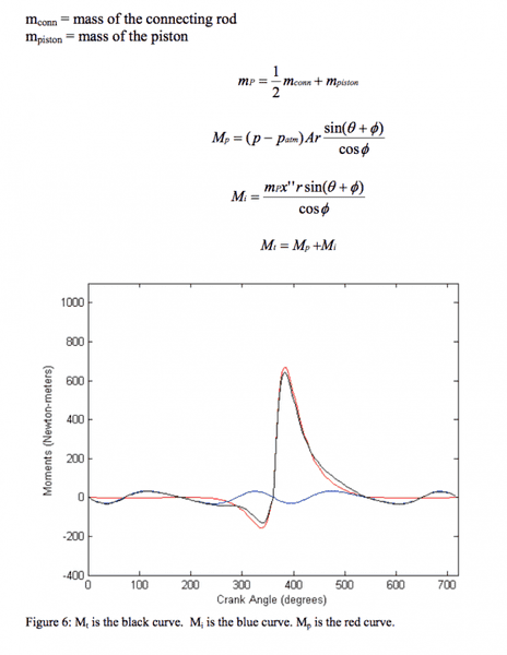

It plots the pressure contribution of the cylinder.
  • Top: equations for mP, MP, Mi and Mi = MP + Mi with defined mass terms. Bottom: Figure 6 plot of moments (Newton-meters) against crank angle (degrees) from 0 to 720, with black, red and blue curves; the black curve peaks near 650 at about 380 degrees.

I think ultimately you need to be much more careful with your units as Nidum said. Note pressure as N/m^2 rather than N/m/m (which is confusing).
The answer is all in the equation. Ignore units for now and conceptually break down the equation into steps.
What is happening at each step:
1. (P-Patm)
2. (P-Patm)*A
3. ((P-Patm)*A)*r
What do the cos and sin terms do to this?
Or try doing this from first principles to gain a conceptual understanding. We are plotting torque yes?
T=F*d
So how to F and d change as we go through the engine cycle? Start with d first.

You need to abstract away from the units. They are actually irrelevant to what's going on.
1. Is net (gauge) cylinder pressure. Can be Psi, Bar, atm, MPa, whatever.
2. Pressure * area = ?
3. ^_^ * distance = ?
Draw the crank throw and conrod vertical. If you apply pressure here, what rotating torque do you have?

So in that left hand image, imagine we apply maximum cylinder pressure (as happens at TDC on an ideal otto cycle). At that instant, how much torque does it make?
I can't specify... :frown:
You can, its one of the cases where you don't need to see any units or values.
If torque = force * distance?
Force acts vertically downwards, what is th length of the moment arm?

I'm afraid not. The answer is zero; no moment arm, no torque. Can you see why?
does it have to do with the fact that the crank angle is zero?
It does indeed. You are still applying the force on the piston though.
If it's not making torque what is it doing?

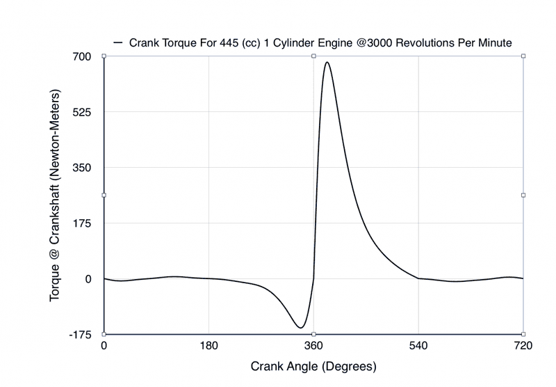

well I know this:
When you generate torque on a static (non-moving/no velocity of any kind) Object, You are still indeed applying torque, but you are not generating any WORK. Correct?
The force is bending the crank. The thing to take away from this is that for every crank angle. The force acting vertically down resolved into a bending component and a turning component.
Much in the same way that gravity on an inclined plane resolves into a normal and perpendicular force.
There are inertial terms arising from both the piston acceleration and the connecting rod (linear and angular) acceleration. These are not constants, and are phased to be associated with each cylinder in turn.
This difficulty with the slider-crank machine is largely due to the kinematics. If you have a good device to handle the kinematics, then the correct equation for every cylinder is easily written using energy methods. This will have every cylinder moving in its proper phase, with the associated terms due to piston and connecting rod motion. To try to cobble together torque functions, etc. on an ad hoc basis is just asking for trouble.
Line graph of crank torque in newton-meters against crank angle from 0 to 720 degrees for a 445 cc single-cylinder engine at 3000 RPM; torque is near zero, dips to about -150 near 340 degrees, peaks near 680 near 380 degrees, then returns to zero.
Yeah, the equations support this. Now, what I'm TRYING to figure out is how to get from (atm*mm^3+kg*degree/mm) to Newton Meters.

Before you get too far trying to convert this result, check the dimensions of your terms. The first part has atm*mm^3, or pressure x volume. This correctly gives you work units.
However, the second part, in kg*degree/mm, is in mass/distance, which does not make physical sense here.
I would go back and redo the problem, putting everything into SI units, and track the units every step of the way.

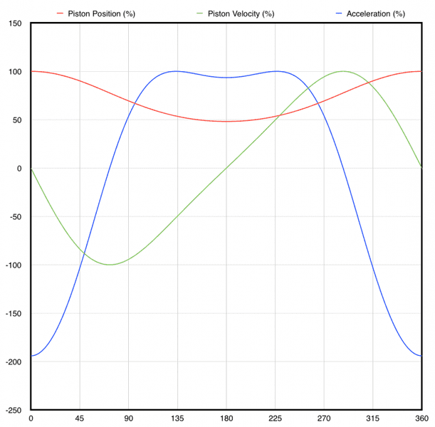

Line graph of piston position, piston velocity and acceleration as percentages against crank angle from 0 to 360 degrees; position peaks at 0 and 360 and dips near 180, velocity swings negative then positive, acceleration is most negative at 0 and 360.
Hi guys, Iv'e been SUPER busy the past few weeks so I didn't think about posting for a while. The spreadsheet has gone through a series of MASSIVE updates, But I won't put in multi-cylinder engine support until a few roadblocks are cleared up. For now, I will post this screenshot and upload the spreadsheet for you guys to check out!
